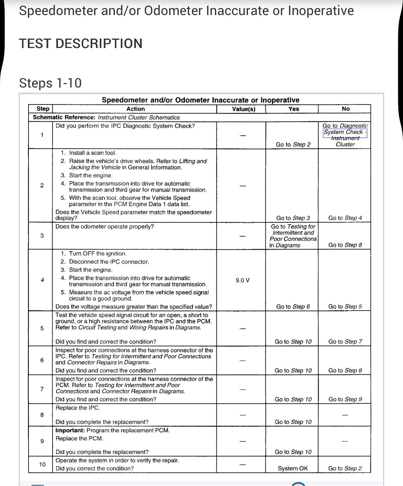

Good luck if you have some electrical experience.
