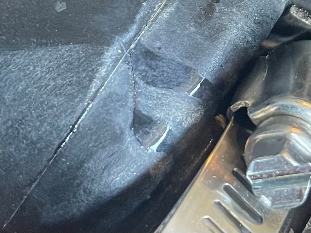

Found this small crack today. Replacing the radiator would be logical.
Do you think I could temporarily get away with repairing it. If so, using what?
This is my 04 CE, original owner…
Edit: I just found a bunch of info about this. So, never mind !! Thx

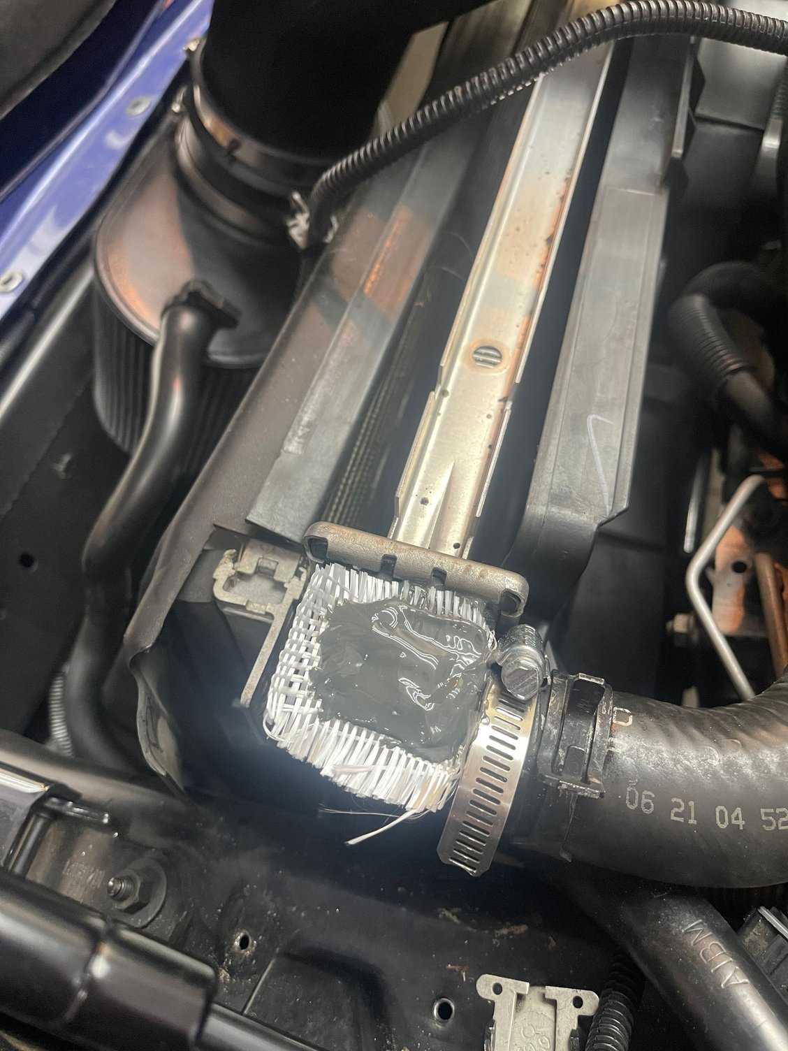

I was part of the team that launched the first aluminum radiators with plastic tanks for GM many years ago. We had to come up with service repair kits for the aluminum core and the Nylon tanks. This was back in the day when people would routinely repair or recore copper/brass radiators so the service network expected these new aluminum radiators to be serviceable too. For the Nylon tanks, we came up with use of an epoxy.

I tried using JB Weld - radiator leak repair not expecting any success. Put some on yesterday, drove around today and it’s not leaking! We’ll see how long it’ll last.

With the amount of screwing around, trying to band-aid a-at least-20 year old radiator, you'd be a lot farther ahead to just get a new DeWitts, or similar radiator. Your fix will work great.....Until it doesn't. Which will probably happen at 10:00 at night, 30 miles from home. I'd never do this, but to each their own....

I do plan on replacing the radiator… this was just temporary…

I did exactly this and every other way possible and could not stop the leak. I even there'd the melt method with an iron, just could not stop the seep. I only changed because i had it out for a engine rebuild but i ran it for yrs with a very little seep.

I used to use JB Weld and fiberglass and leave the cap untightened so it wouldn't be pressurized.... while I was waiting for the replacement to arrive.

I did the same thing. It takes some time to get a Dewitts plus their fan. Now, I don't have to monitor climbing engine temp in stop-and-go Los Angeles traffic, and the fan works really well. My original fan still worked, but the casing was warped, and the Dewitts is twice the width, so there was no room for a warped misfit or time to see if it might fit.

I kept the cap tightened, the JB Plastic Weld works surprisingly well-d. lol.
