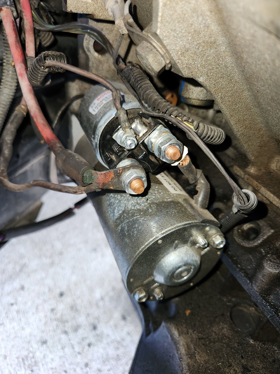

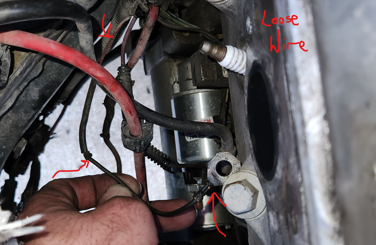

I have had the charge system fault, and service vehicle soon message for a while. It does seem to affect anything, but havent been able to figure it out. I did research today and everyones issue seemed to point to the starter wires, so I bit the bullet and pulled the header to really inspect them. None of the wires look "great" but there was a wire that was loose in the area (which Im guessing is causing the problem but I have no idea where it goes. It seems to be reddish in color. any help would be appreciated. Also, getting to this is miserable, so if there is anything else or other wires I should replace, please let me know!

NVM, I figured it out...supposed to go with the other red power wires!

Yep, I would also do some serious cleaning of the cable lugs.
