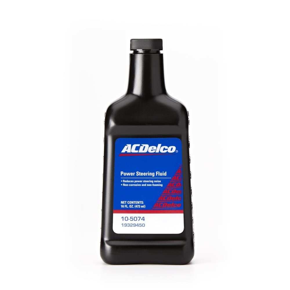

Can gm part no.1052884 be mixed with 19329450 power steering fluid?

Looks to be just old vs new part numbers for oem PS fluid. The formulas may vary minorly but the fluids should coexist peacefully. No one balks at using a gas station or box store fluid to refill if they spilled some. I would have even less concern using like GM and Delco products.
The ebay link I found for the old set here actually included the term "vintage" in the title. Couldn't hurt to flush the old fluid in the system if it is 20+ years old. There is a whole process for this with the PS system which comprises a few bottles of fresh, getting the car in the air, turning the wheels lock to lock numerous times to work the old fluid out and replace with fresh. So I also don't blame you for topping up and driving off.
