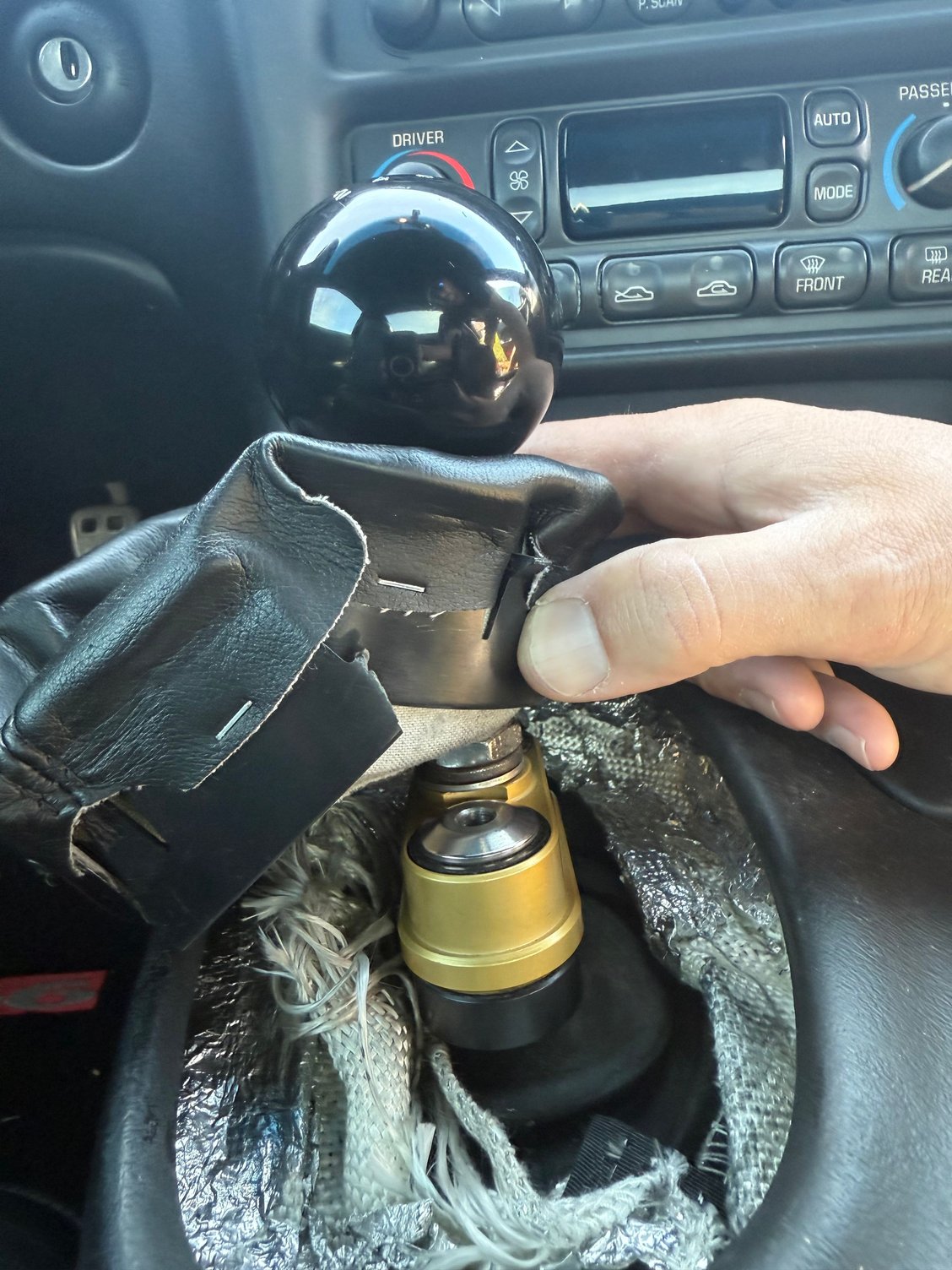

Originally Posted by isaiah mitchell
it sometimes spits me out of second and reverse and is notchy into third, the problem with second gear popped up within this last two weeks and I haven’t been driving it since it happened. I figured if the alignment doesn’t work then it has to be the synchros or something internal. Last fluid change was 2,000 miles ago, but not performed by me, might be a good idea to see if it was done right. It is an aftermarket shifter. If it won’t throw everything out of harmony by removing the shifter then I will try it when I get home. I’m sure I sound dumb lol but I’m pretty new to this so I just wanted to make sure I wont mess anything up before I take it apart more.
What after market shifter do you have? I am experiencing similar issue with an older model mgw short shifter. My second doesn’t kick me out but sometimes doesn’t want to go in smooth. Reverse does at times not want to go in. I did the antivenom mod which is cheap and simple and seemed to smooth it out a little and I thought it fixed my hard reverse issue but came back. I also had Chevy replace transmission fluid recently too. I don’t have the alignment tool for the mgw short shifter so I was wondering if you had the same shifter to see how you aligned it.
What alignment tool are you referring to?
Got it. So you need an alignment tool for your type shifter. Looks like they are available from a few sources. So what's the question?
Well i guess the question is where is the alignment tool available, because I was under the assumption they were only available with the shifter since I didn’t see them on mgw website and someone told me mgw doesn’t sell the individually. Other than that I was curious what shifter the person who posted this had?
https://www.ebay.com/itm/326603697861

Old Dec 16, 2025 | 08:08 PM
Bushyeyed1's Avatar
Bushyeyed1
Joined: Nov 2025
Posts: 15
From: South Alabama
Well I got my alignment tool. Took off the mgw short shifter and I guess the first gen used the original shifter box. Either way I aligned the shifter and now seems to get into reverse easier. Only thing now it feels notchy through shifts. I may take the anti-venom mod out now and try it. I put it in assuming it didn’t have the stock shifter box.
