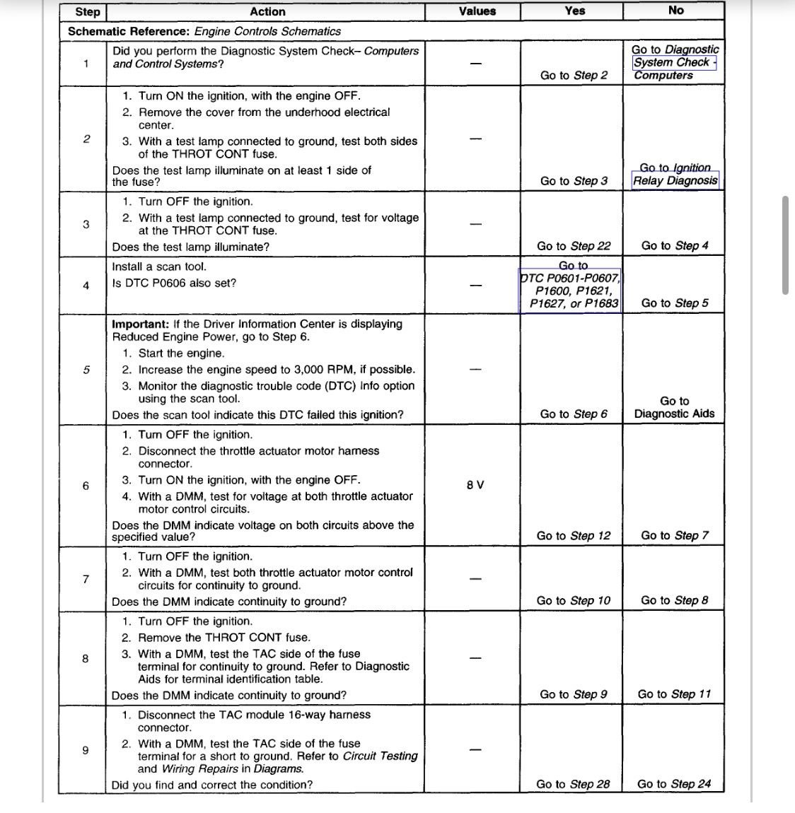

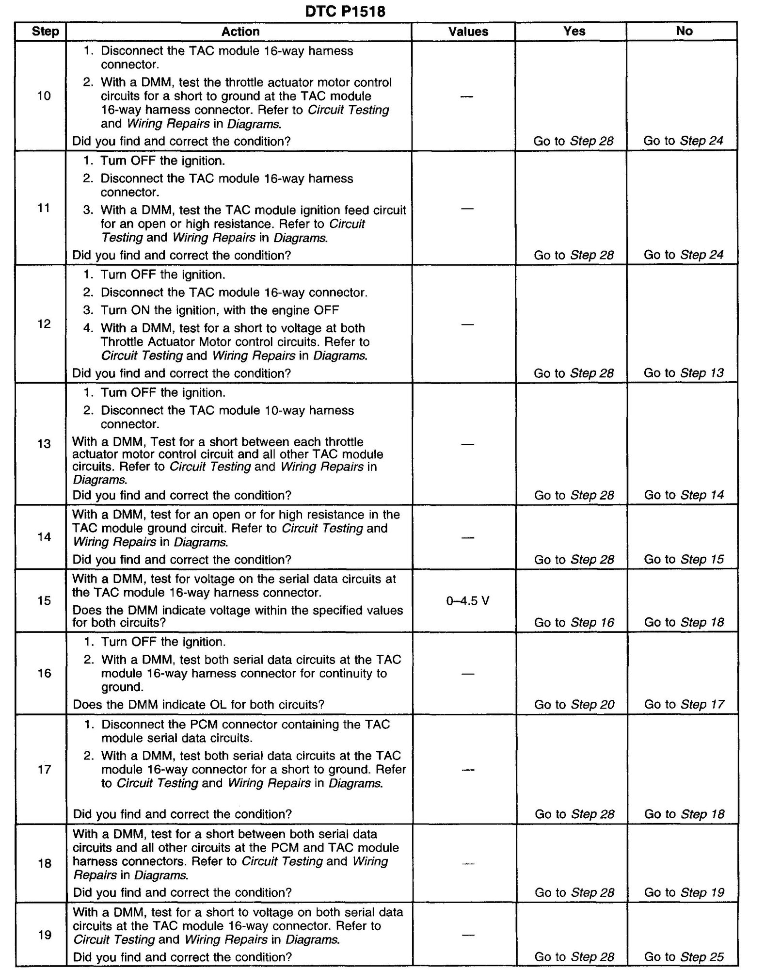

If your diagnostic knowledge doesn’t go beyond spraying Brake Kleen or looking at the Tach seek out an auto diagnostic shop in your area…below is the factory flow chart for the P1518.

If proficient and have a DVM check for 12v at fuse 17 in the engine bay fuse box, with Ignition switch in the run position. I would also check wiring at the pcm and tac modules, you will have to remove front passenger tire and unblot the cover on the fender liner to access the wiring. Pull and remove the connectors at the pcm and tac module's and check for corrosion, a shot of electronic contact cleaner won't hurt either, disconnect negative battery cable beforehand. The buzzing you are hearing is most likely a relay, caused by a low voltage condition due to repeated cranking . Hope this helps.
