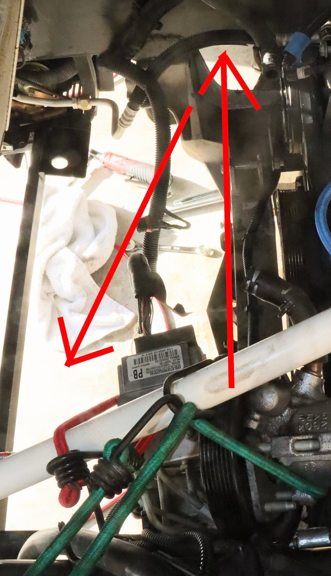

Old post…Easy way to remove steering rack
Good day in the shop. Got the rack and balancer out, but did have a power steering fluid shampoo in the process. With the rack on the floor I was able to get a socket on the stuck pump fitting and it came out fine. No damage to the threads. Whew!
That out of the way, the rack slid right out. I rolled it about 90°, moved it about 1 1/2 feet to the passenger side, then pivoted the other end toward the front of the car and it went out with no interference.
Leaning over the DS fender

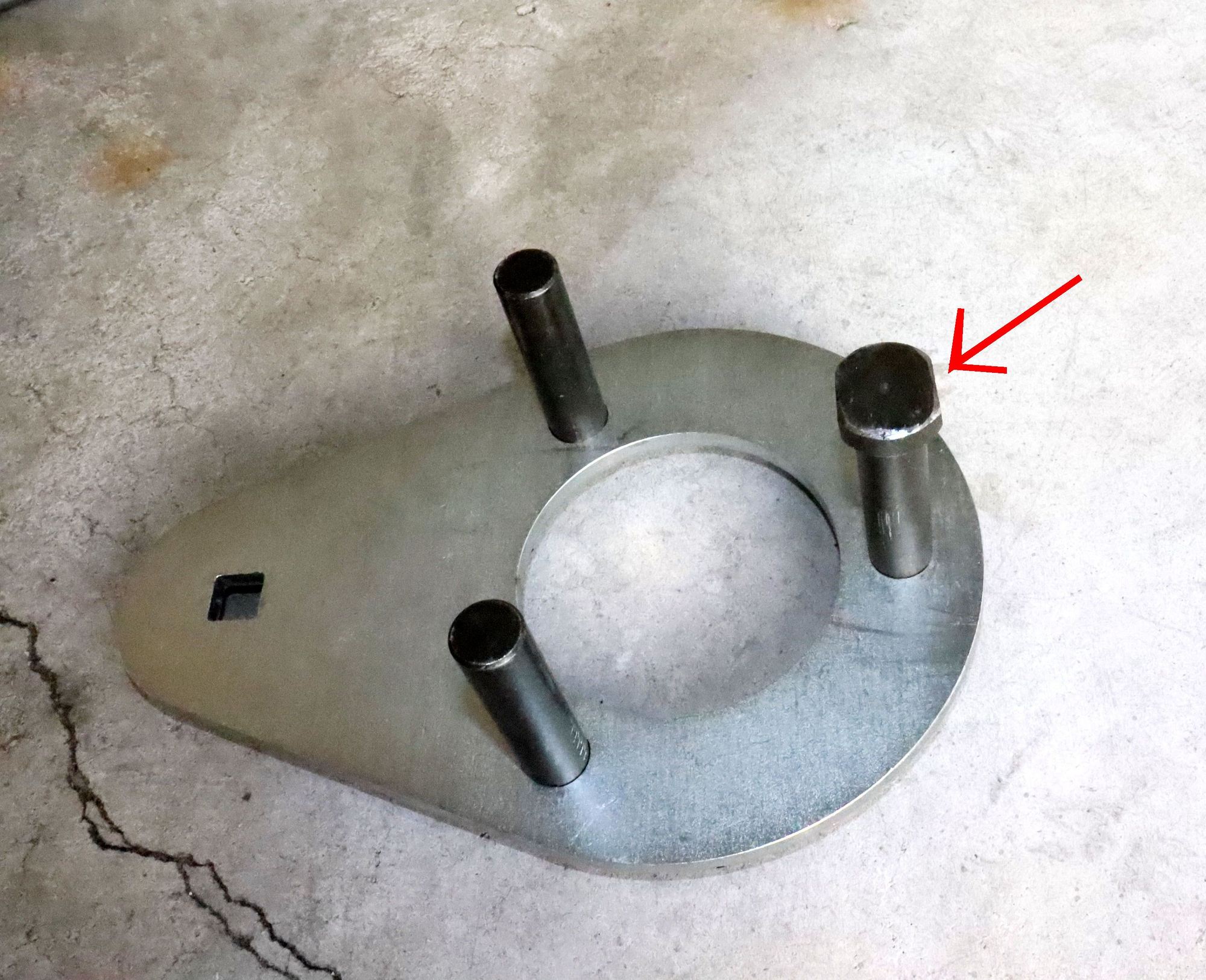

Used the OEM Puller on the balancer and the Summit crank brace to get that bad boy on the ground. The crank brace worked like a charm, but I had to grind the sides of one of the stems to fit through the balancer.
The summit brace is a must.
