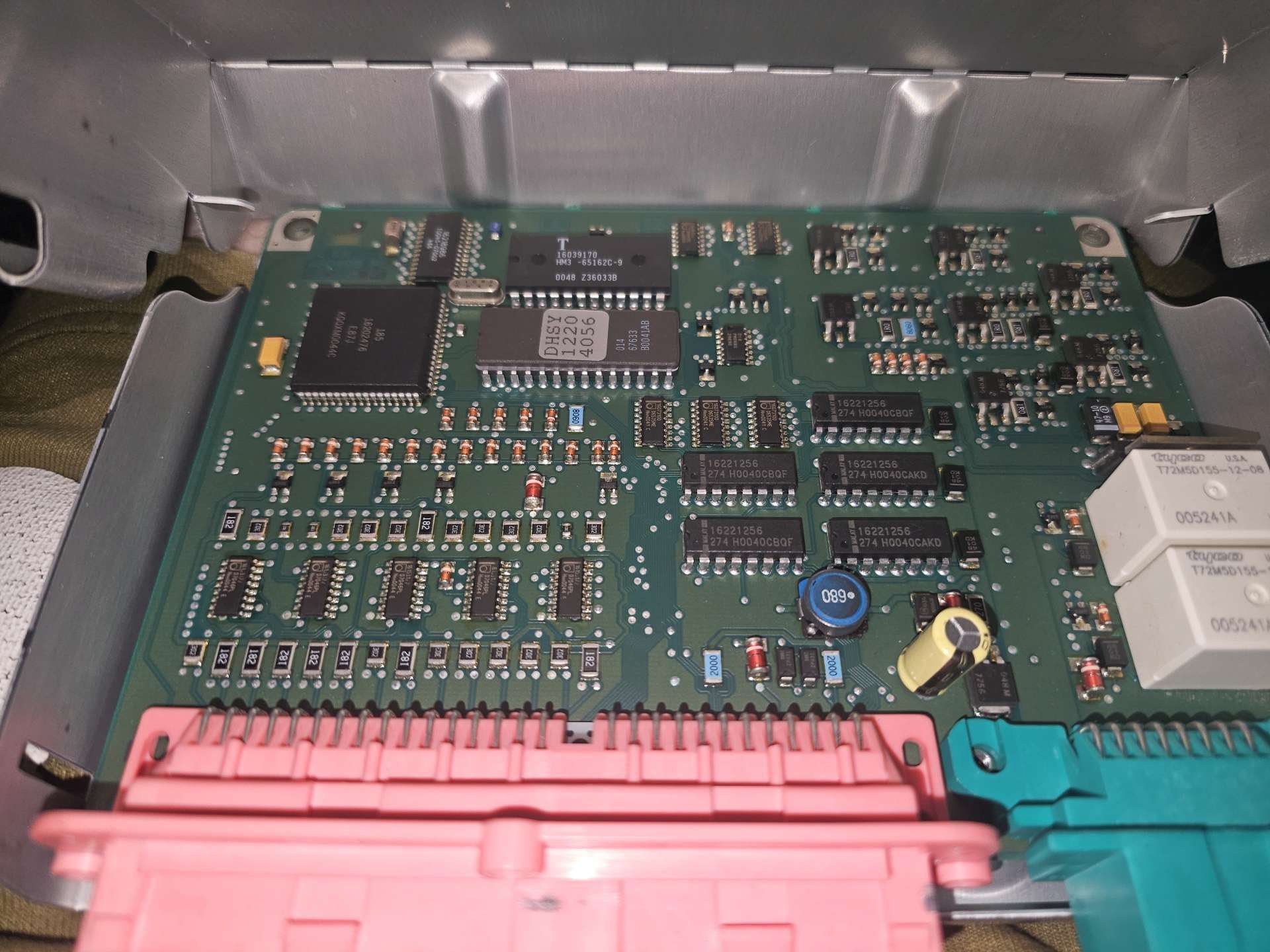

Attached below are pictures of the BCM Board, no apparent damage from what i can see.

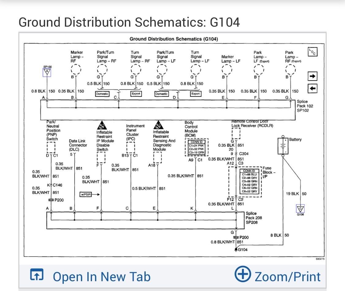

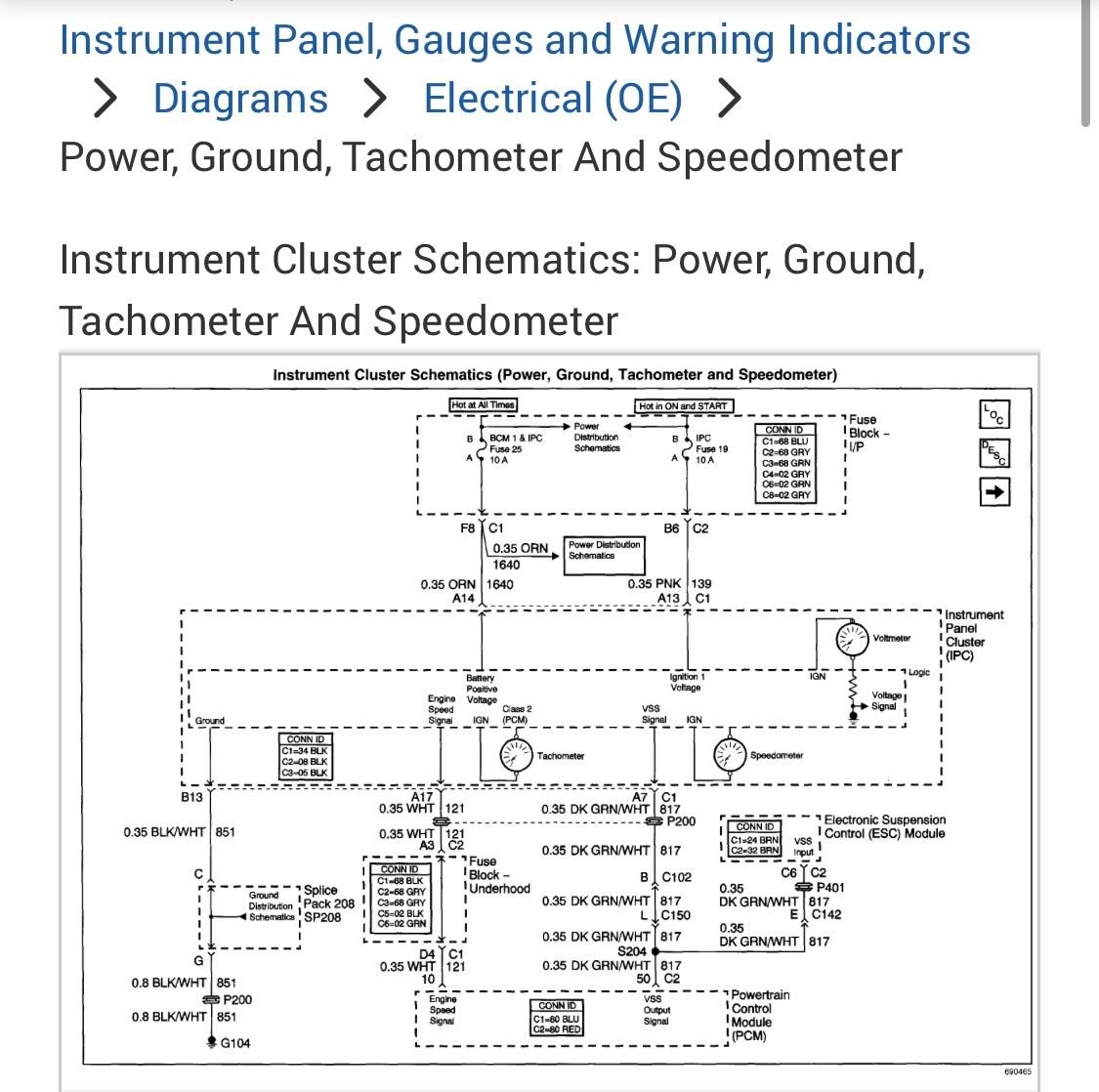

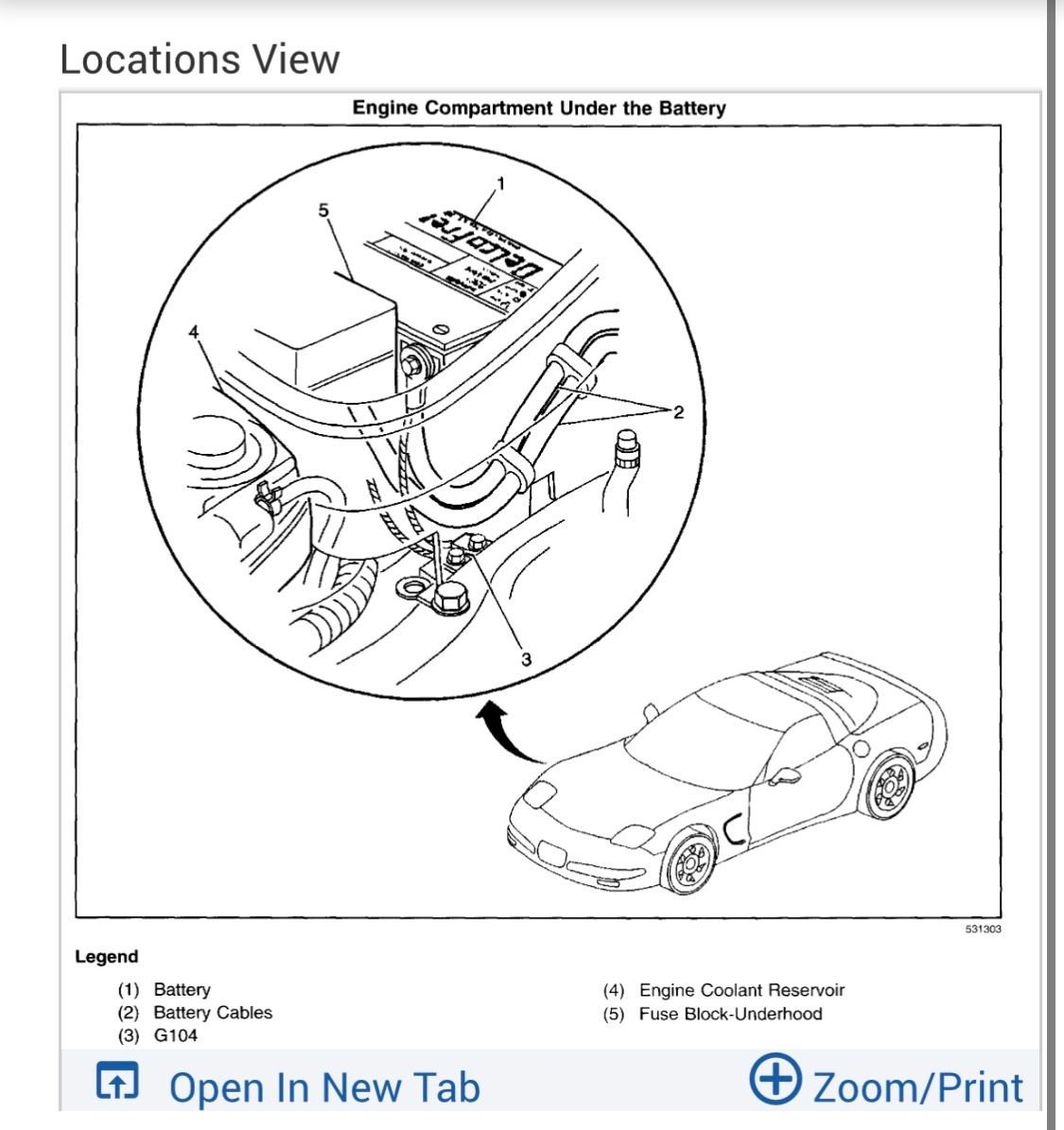

Looks like a ground issue and exactly which ground or grounds have you checked ??...a visual inspection is not the way but you must load the ground with something like a headlight bulb of a few amps...did you check (load test) G104 under the battery tray ??
