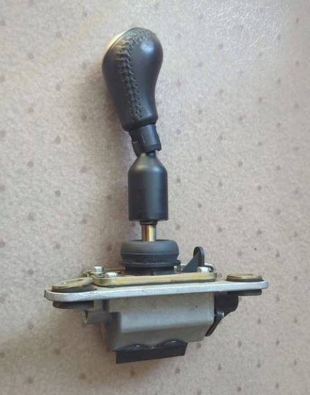

I purchased this mint C6 shifter assembly out of a 2012 Grand Sport, for $75. Deals are out there.
