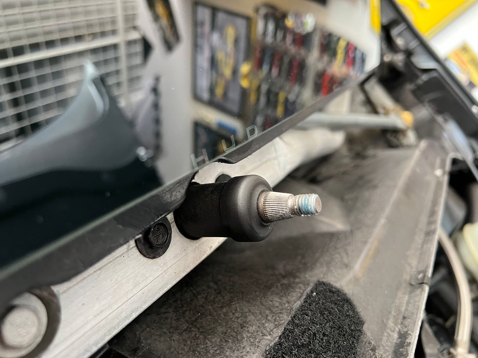

This is what you’re looking at with the cowl and wipers removed. Not sure what could be stopping the removal. Hopefully the PB Blaster will work.
