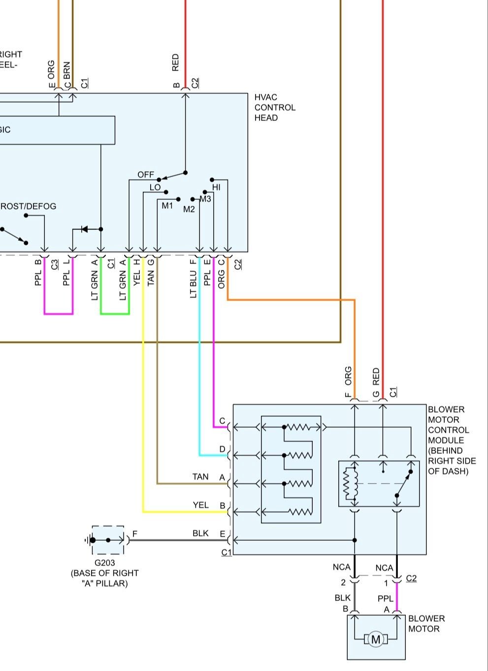

Should the blower motor be recieving 12+ volts when the blower speed indicator on the control head is on the highest setting?
Also the schematic lookslike it is for a Manual control, where as i have the climate control .
Wouldnt it be easy enough to use a multi meter to checj the voltage at the blower motor? and also as I decrease or increase the voltage to the blower motor, I could also see that at the meter? But then would I not be checking the amp to the motor . It has been suggested to me to use an old headlamp, because as I increase and decrease the voltage to the blower motor the lamp would get brighter and dimmer.

At the highest speed all of the resistors are being bypassed so you should be seeing somewhere around 10-14 volts...removing the connector and just checking "open circuit voltage" for proper voltage is meaningless !!
