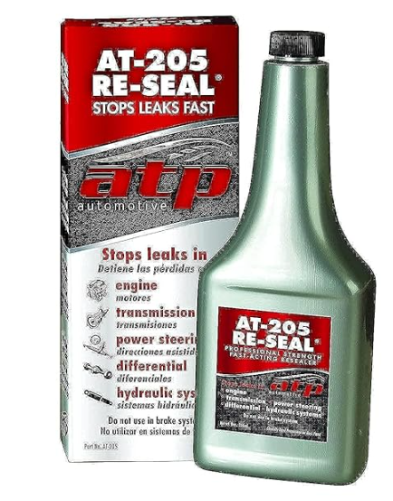

You've done some nice work on your C5. Congrats, and it seems like you're enjoying the journey. We like pics - post some up of yours.
I had a rear main oil leak in our 65 Sting Ray. Here's my post on the C2 forum regarding how I fixed it. I was surprised with the results, and the car still doesn't leak a drop of oil.
Another member posted about the Blue Devil stop leak, I have no experience with that.
Unlike some other stop leaks I've used that are like thick oil, this stuff is clear and as thin as water. I just changed oil, added the bottle and drove it. I recently had a small transmission leak in our A4 C5. I pulled the transmission pan, changed fluid and filter and added a bottle of AT-205 and drove the car. So far, no more leaks. If it doesn't work, you're only out about $20.
Good luck!
https://www.amazon.com/dp/B000NVW1LM?ref=ppx_yo2ov_dt_b_fed_asin_title&th=1 https://www.amazon.com/dp/B000NVW1LM?ref=ppx_yo2ov_dt_b_fed_asin_title&th=1

I have also used Blue Devil stop leak. The stuff does work well, real well, actually.....

Thanks for the tip. to be honest, I have always steered clear of additives for leaks - but maybe the time has come?
