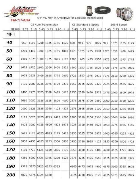

Got a got used 3-ribbed diff... sending it to be rebuilt... what rear gear????
2002 Head and Cam ZO6... trans already rebuilt... all trans ratios factory.
3:73.... OR.... 3:90 ???

With the Z06 trans gearing 3.90/4.10 might be a little much. Theres a good chart somewhere on here showing the rpm/mph in each gear with different gear ratios you should check out
Seek and you shall find. I agree with cautioning the 3.90 or 4.10 as they could be a bit much with the M12 trans. I sure do love a 4.10 in an NA C5 with an MM6. So I vote 3.73 with the M12 which is between 100 to 150rpm higher than the MM6 w/4.10 across all 6 gears. And if you decide to boost it for big power you're more likely to regret going lower than 3.73 with the M12.
