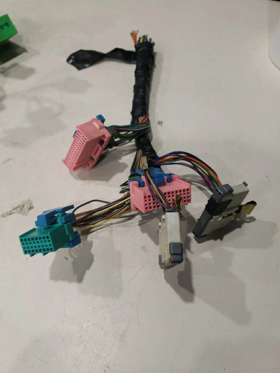

Search flyBay, there are many listings for BCM harnesses pig tails...you may be able to get something and cannibalize connector pins and wires
97-04 Corvette C5 OEM BCM Pig Tails 7120-1 - Picture 2 of 2
