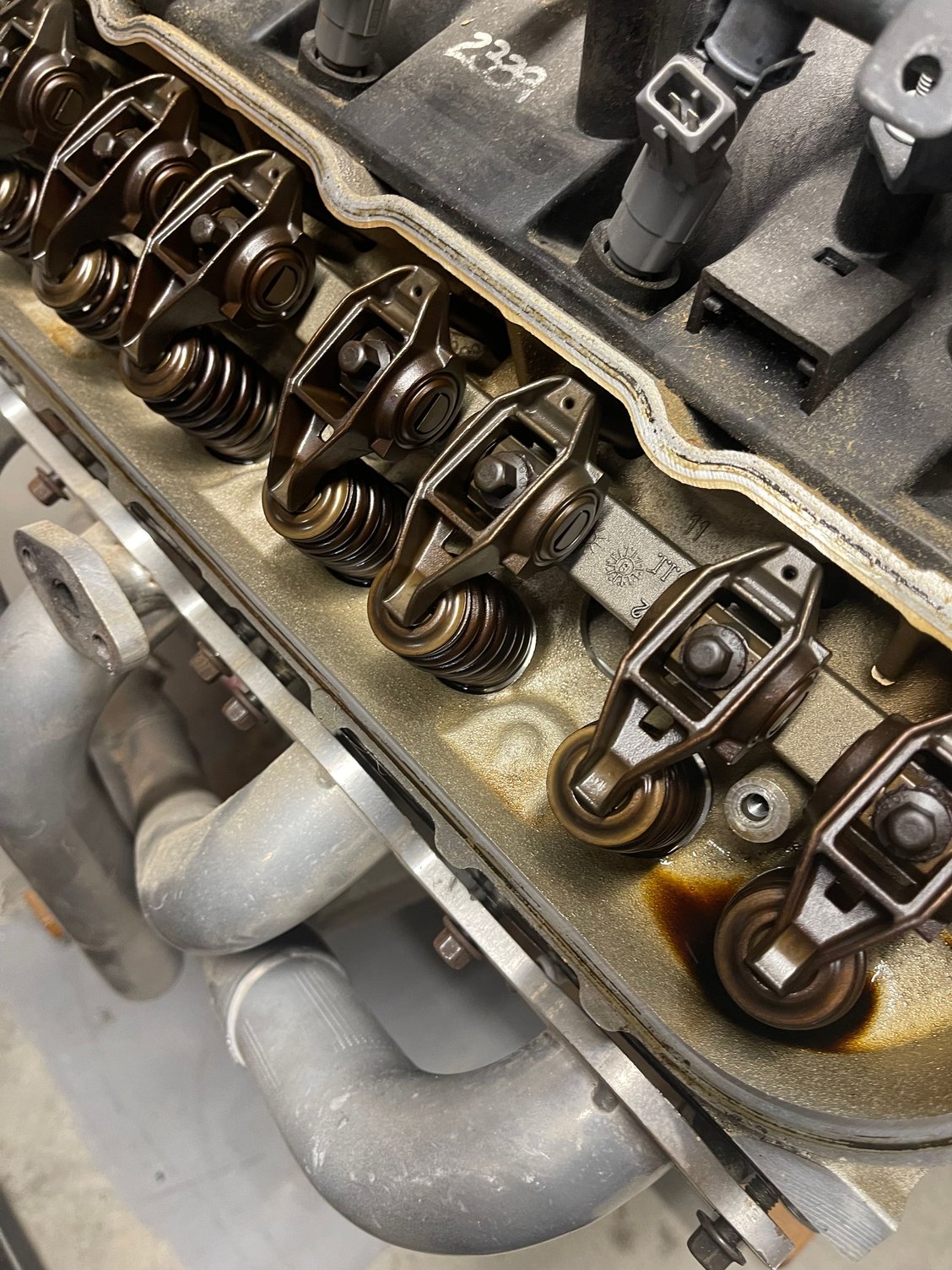

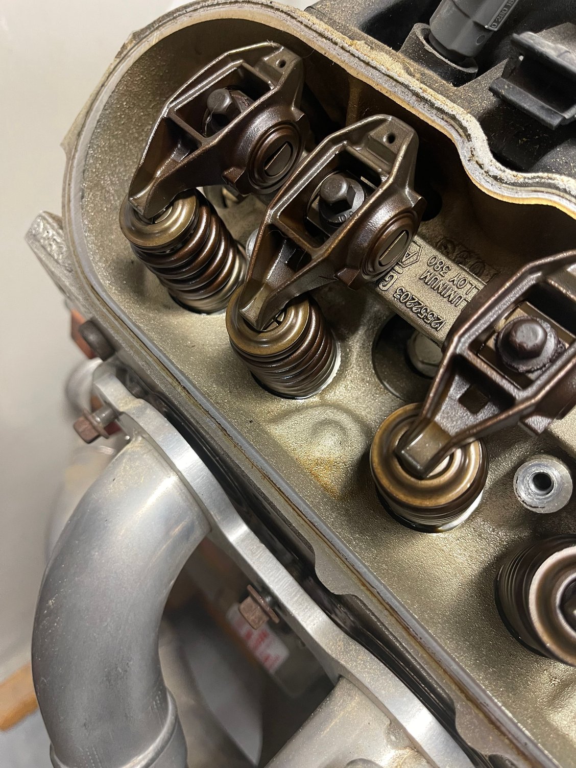

I have a ls1 out of a 99 FRC that I was told had 116,000 miles. I’ve had it since 2016 and bought it for a swap project that has never started. It’s on an engine stand in my basement and curiosity got the best of me so I decided to at least pull off a valve cover to see what it looked like. I was pleasantly surprised with the appearance although I know that doesn’t tell the whole story. I did put a socket on the crank and it turned so not locked up. Comments?

Wouldn't hurt to do compression tests on each cylinder.

If you check each cylinder walls and there is no surface rust its as good as when it was shut off last. You crank that baby right up and it wont skip a beat. You dont even have to prime it there will be plenty of oil on the bearings.

Can't really tell much, but 116K miles is not too bad for a well cared for engine, they can easily go to 250K with good care.

Looks well maintained. No sludge anywhere.....

If you have an engine thats been sitting for 10+ years
First thing is take plugs out, prime the oil system with no load, wait for good mechanical oil pressure on the back of the intake port for LS
Then compression test
Good chance its got hard diamond like carbon buildup on valves so heads need to come off for at least a cleaning
Would not compression test a sitting engine without first priming the oil system with plugs out though
