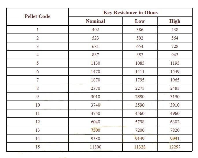

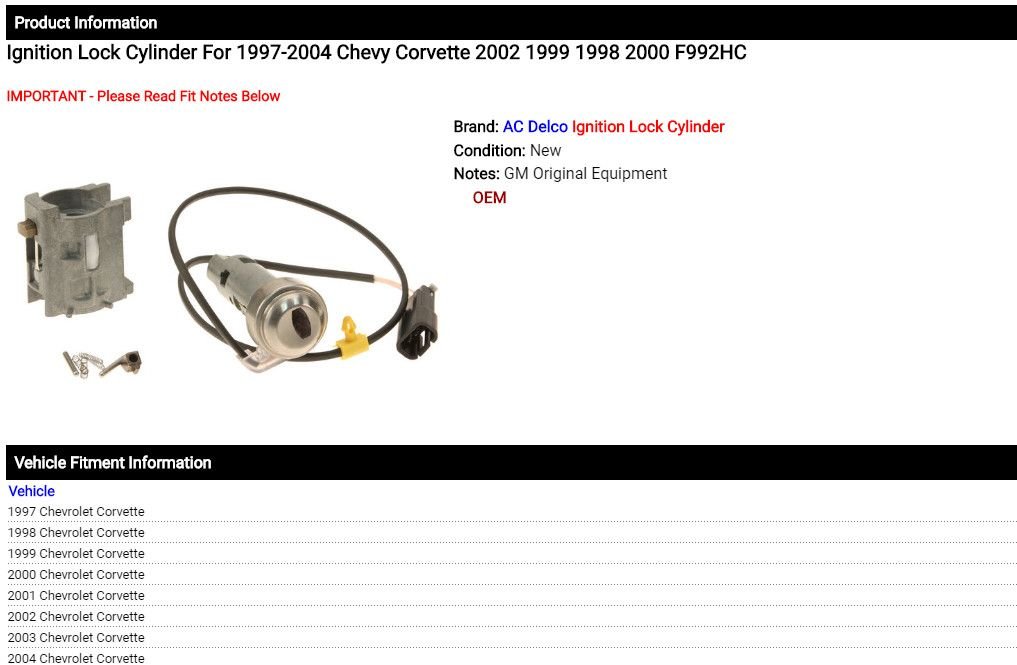

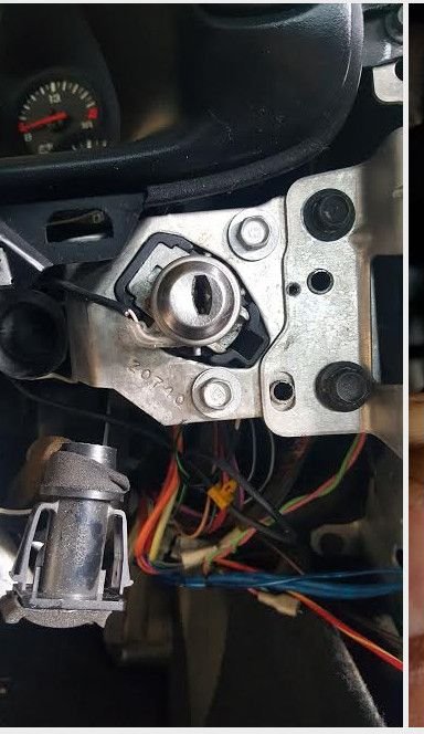

I recommend first to disconnect this black plug close (first photo) to the ignition switch location .
Connect a multimeter in ohm (resistance reading) to the two pins in the plug
These two wires come from the the sliprings (second photo) reading the resistance in the ignition key .
If the sliprings are weak or dirty the resistance readings will be unstable/wrong and outside acceptable range (last photo)
Try to clean this sliprings and increase the slipringpressure to the key by bending the springs carefully .(or replace it if neccesary)
Good suggestion, and this information needs to be understood as part of the troubleshooting process. While the BCM does monitor the key while the car is running ....which you have definitely proven, I have never seen a intermittent lock cylinder cause a complete shutdown of the engine. Sounds like the OP has two problems here.
