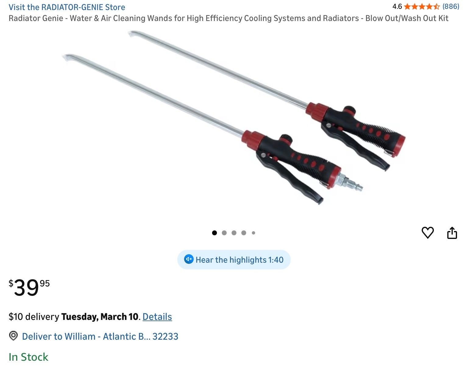

Cleaning the fins on both are reeeely important on these hot rods. You can jack the front up and look up into the radiator shroud and bet you find a bunch of crud near the top of each corner. That’s a good starting point. Then remove the radiator hold down and use some air and water.
These wands are priceless!
Thank you for the cleaning suggestion! I will order the Blow Out/Wash Out kit today. Also, in addition to cleaning the radiator it's probably time for a flush/new coolant and I will probably install a new thermostat while it is drained.

Just be careful if you use water! When using water with a nozzle on a garden hose, even at normal hose pressure, will produce enough pressure to damage/bend the delicate fins. For this reason, I only use air.

Will do. Thanks for the heads up.
