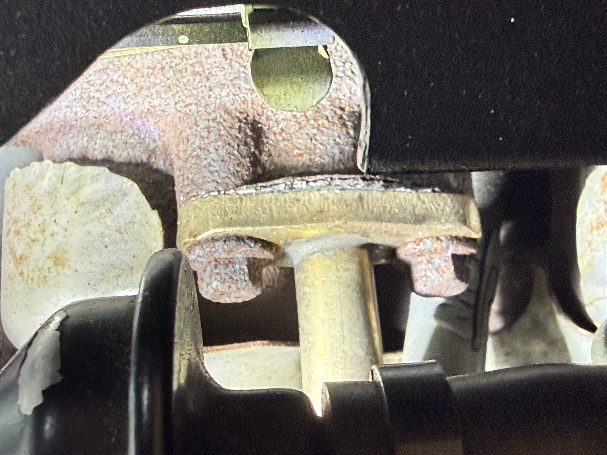

If I remove the A.I.R. System. Does this have to be plugged on the exhaust manifold?
