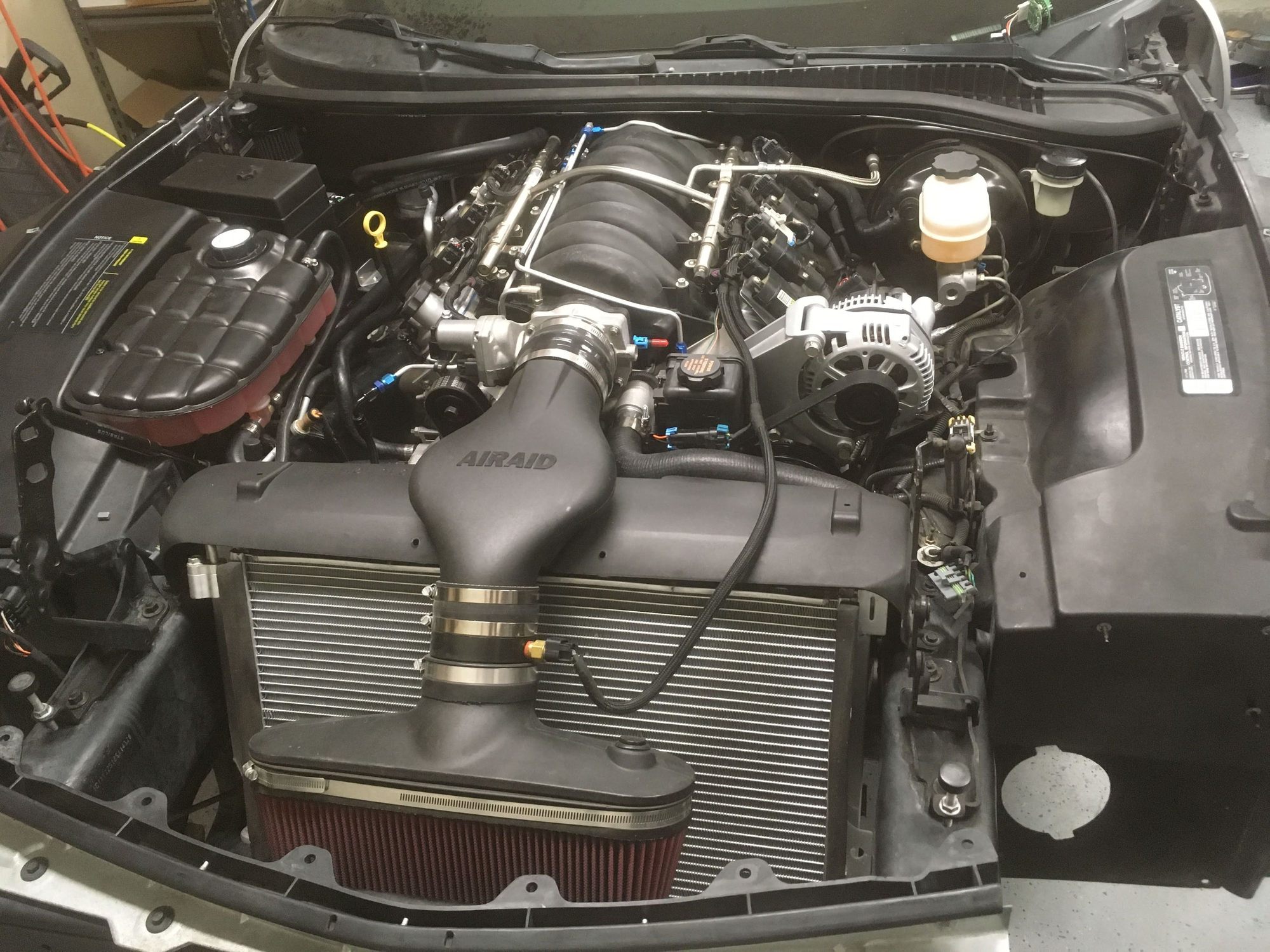

I used the Motion Raceworks 4 port kit, and bent my own hardlines to fit over the LS3 manifold, also on my 408
Welded a 6AN bung into the aftermarket radiator and routing everything to it
