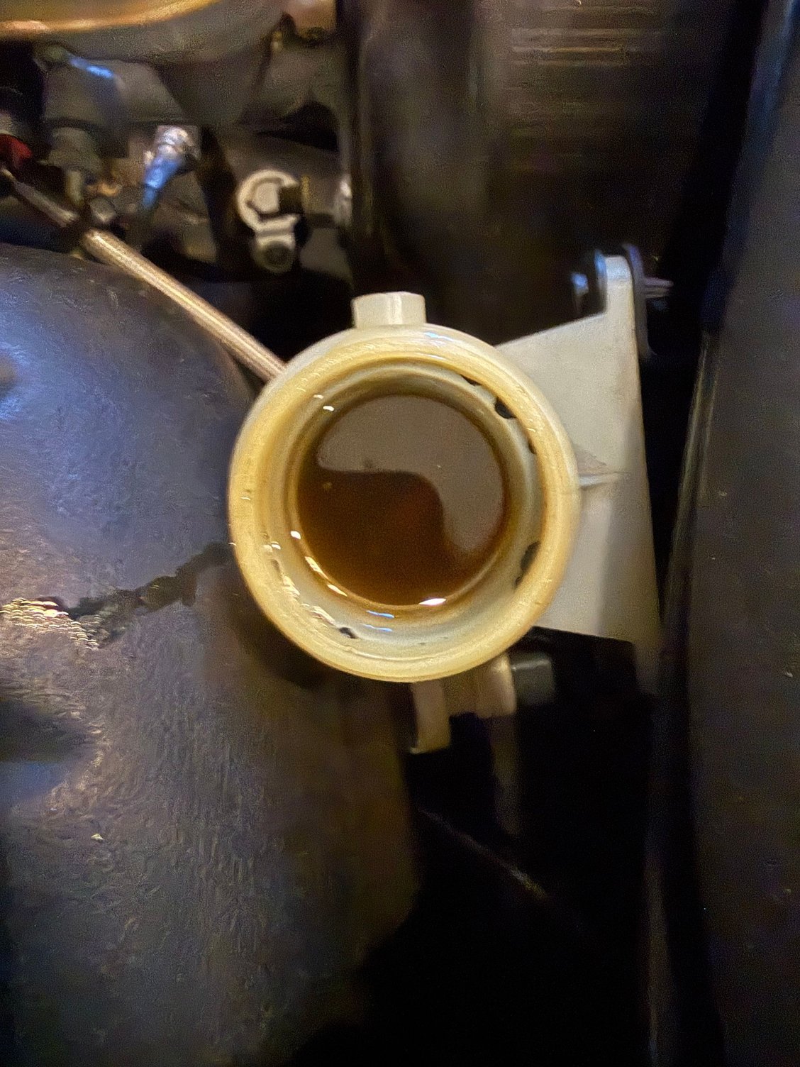

Hoping that it's not a hydraulic fluid leak from the clutch master cylinder or slave cylinder. Might have to lift the car and check for hydraulic fluid, also remove inspection cover on bell housing to look inside.

Old Mar 23, 2026 | 05:51 PM
Espi2's Avatar
Espi2
Joined: Nov 2024
Posts: 204
Likes: 45
there is definitely a good amount of clutch fluid although it does look dark.

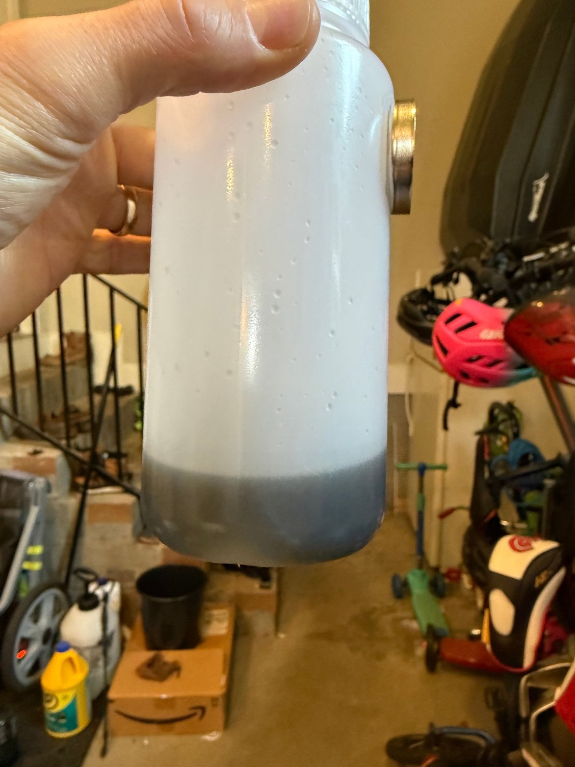

Old Mar 26, 2026 | 03:43 PM
Espi2's Avatar
Espi2
Joined: Nov 2024
Posts: 204
Likes: 45
Bled the clutch today - black fluid in the slave. Unfortunately, no change - car won’t shift into any gear while on. Any other troubleshooting ideas before getting it towed to the shop for a presumed slave/clutch job.
Old Mar 26, 2026 | 11:26 PM
mmartinez's Avatar
mmartinez
Joined: Sep 2008
Posts: 3,101
Likes: 789
From: Espanola New Mexico
Pretty clear that clutch is not disengaging, hence the not being able to shift into any gear with engine on. Good luck
