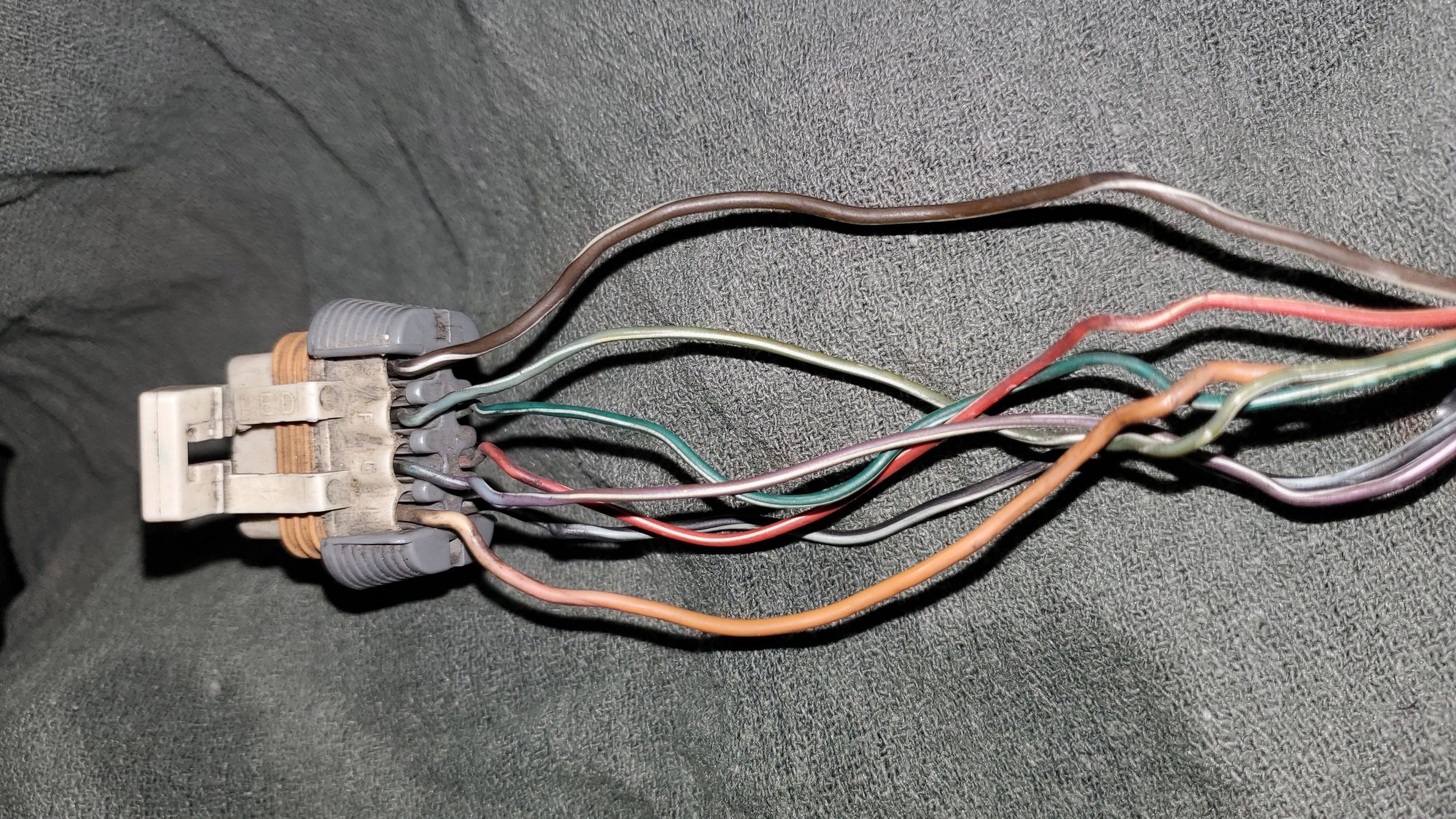

Start with map sensor. A- Blk/white wire low ref ground gets 5v from C-orange 5v supply and orange to neg battery gets 5v. key on engine off B- signal wire to A- low ref ground is 1.5v when i pull vacuum volts go down to .25v at -20hg.( HPTurenes scanning shows 15kpa not 95kpa when engine off key on.
I have not checked CKP sensor valves or wires yet saving that for last since starter has to come out. But when cranking tach does not move and verified with HPT rpm stays zero so no signal from sensor when cranking.
Ignition coils main connect with 7 pins. orange gets 12v to ground but when i check supply 12v orange wire to the other wires they all get 12v but if i check each other wire to ground all get 0v. and when i check for continually from supply 12v wire to ground i get continuity. All the other wires to ground i get 1000omhs.
When i check the 4 wires to each coil i get 12v Pink supply and pink to check each of the 3 wires shows 12v from pink When i crank pin c firing signal get no volts no spark.
Fuel injectors 2 wires. Pink gets 12v to ground stripe to ground 0v
stripe wire with test light to ground when crank does not blink so no signal from PCM same as coils. When i check between pink and the stripe wire i get 7.8v This is unpluged from injector
So since i didn't physically check the CKP sensor. Can a bad CKP sensor effect all these other issues. Hope it makes sense.
One lead on the orange wire to ground 12v . And from orange to each other wire i get 12v. But each other wire to ground 0v and from each other wire to each wire but orange is 0v. This is main feed to coils
Pink wire to ground i get 12v. From pink to each other wire i get 12v but the 3 wires to ground i get 0v. Green is the signal wire when crank 0v no signal.
I searched but cant find a 1999 pcm wiring diagram. If these are related to the PCM. Have not back proded to PCM yet. Don't have diagram.
And from ground wire from coils to + battery i get 12v Wire on the back of head. Yes cleaned the grounds to car chassis.
Any ideas or any questions to verify any or all confusion.???

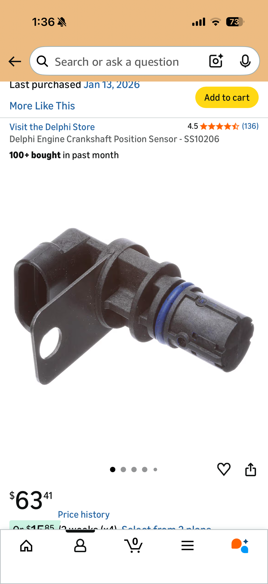

This is the sensor I used to replace my failed one on my ‘02 C5 recently. It’s a Delphi. Worked perfectly. Amazon
https://a.co/d/08oFug5F
Nothing Comes up for CKP
To Car Died
Good lord.....don't buy off Amazon.
Fixed it. See above. It’s from the official Delphi store, on amazon.
Well that's the fun part of gambling occasionally you win.
So it's the official Delphi store that's really the unofficial Delphi store because they were bought out years ago. There is no Delphi anymore. Parts are still sold under the Delphi name although any quality and association with General Motors is long gone.
So anyways, don't buy parts off Amazon
