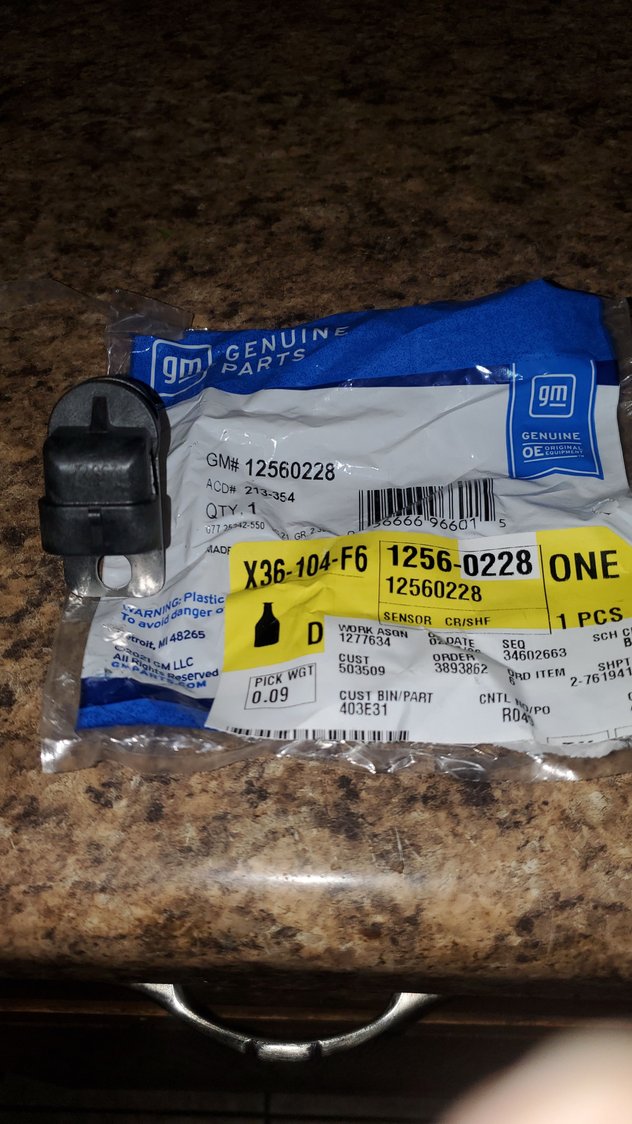

OK guys, updte got to start off WTF happened to GM. All wires was good. Installed car started right up. He's been driving it everyday. After install i had him shake the **** out of the wires every day before start up and no issues. But i told him it was not my fault we bought from GM site that acutely supplies GM dealers. So you tell me.
I told him i found a dealer that had 1 in stock and he brought the package and the pic. And it was the same. as dealer. So the long out come of this issues i have i ideal.The one on Amazon does not have the china on their CKP or that is just a generic pic which they use. He understood and if it goes out he knows how to change it now so my handes are washed from this situation.
