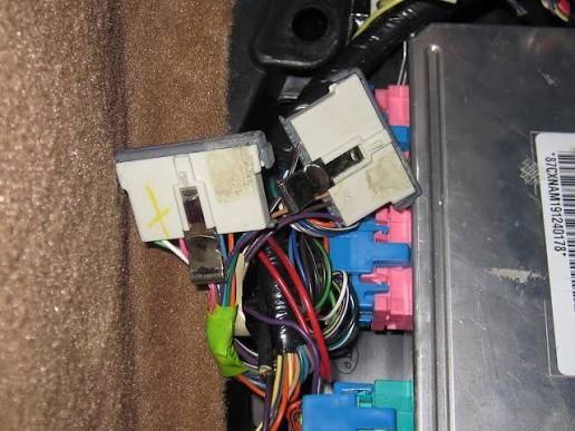

Does any one have a picture of the star connector. I dont have any manual’s yes

Old Apr 6, 2026 | 03:20 PM

Which "ground packs" did you check ??...if you are referring to both of those splice pictured those packs they are NOT grounds but instead your class 2 serial data is sent over these wires and you don't check them using resistance and did you check "powers" too ??...sounds like this testing may be over your head...you should seek out an auto electric shop in your area....on the splice pack wires you will see a 0-7 volt square wave on a labscope.
