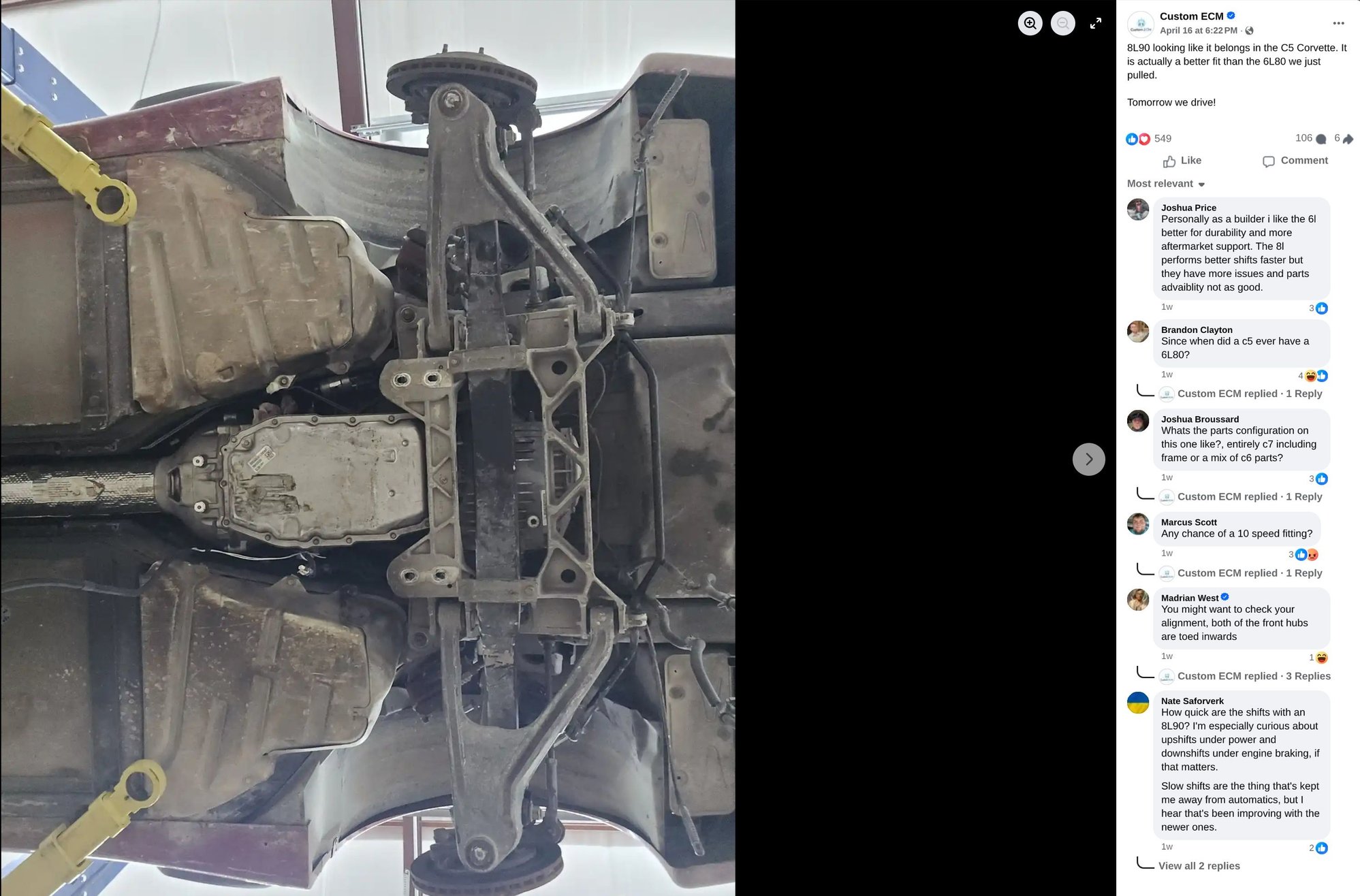

There's a couple of shops out there putting 8L90's in C5's. Here's one actively doing it at the moment:

I detest 4-speed autos of yesteryear. That is well known of me. I could never justify the expense and headache of a TH400 built for a C5 vs an 8L90 or 8HP.
An 8L90 is a different beast and entirely worthy. That is having your cake and eating it too.
I would be curious how they get the slappy paddles to work in a C5. I wager a BT feed from some paddle functions out to a reader then to the trans canbus. What are they using to run the 8L90 itself?

For back in the day, running around with screaming converters and high rpm and poor gear selection on the street was a price to be paid for relative consistency and strength. That is no longer the case. Now you can have a strong unit with decent gears and overdrive and a car which can be your grocery getter AND your track whip. If both kits ballpark similar expense and customization then there is only one direction for me. Owning a 3 speed on anything short of a dedicated track car today is entirely outside my interest. Particularly on a sports car. I've had them. Never again. That's just my opinion a D where if send my money.
For anyone building a car and ever planning to sell it, I wager the 8L90 is the easy sell too.
