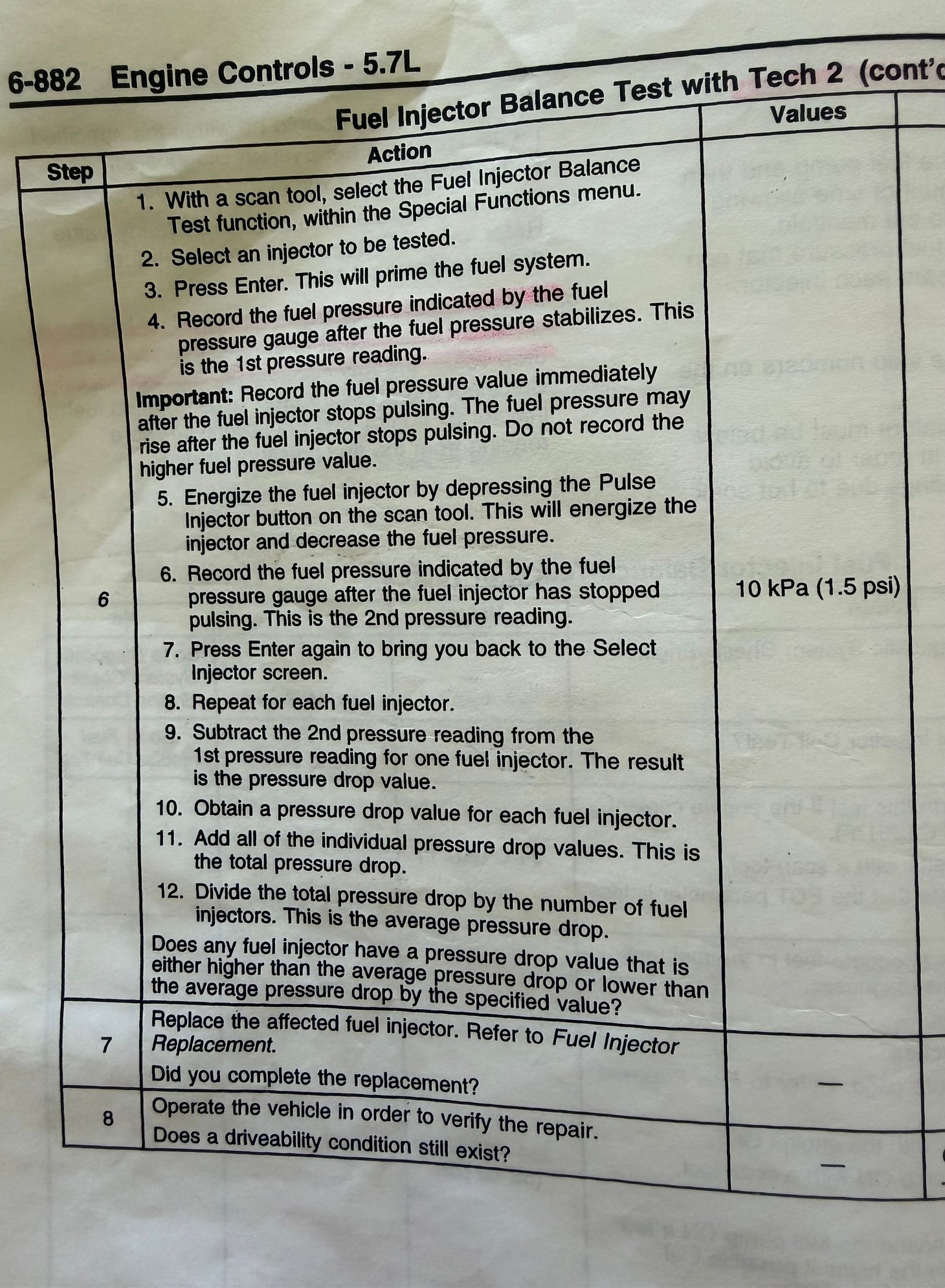

I’ve had my ‘04 Z06 for a few years now and it has had an intermittent, random misfire at low engine speeds that cleans up under load. I grabbed a fuel pressure gauge from autozone this evening and ran an injector test using my gearwrench scanner. All cylinders dropped to 48 psi after finishing their pulses except #1, which only dropped to 52 psi.
I’m new to diagnostics, so looking for some validation. Does this signal a clogged injector?
If so, what can I do to clean it? Should I just buy a new one?
I checked the resistance on the seemingly clogged injector and it was just above 14 ohms, same as the others.

Yes, sounds like a clogged injector...if I were you and it is within your budget I'd replace all of them...no Amazon or EBay though !!..if you have a vacuum leak your fuel trims will be elevated...if over 10% raise the idle to 2 to 3,000 RPM...if they decrease you have a vacuum leak...if you want to learn diagnostics you won't learn it turning wrenches...watch the Scanner Danner YouTube channel...he will teach you...beyond plugs and wire the DIY'er will usually have no success.

@C5 Diag - thanks for the advice. I will check out the Scanner Danner videos. You suggested replacing all the injectors. I can certainly do that. Should they have dropped farther than 48 psi? Is there a brand to go with? Are the remanufactured ones ok?

Please read Service Info below...there is no set pressure that the injectors are going to drop !!
