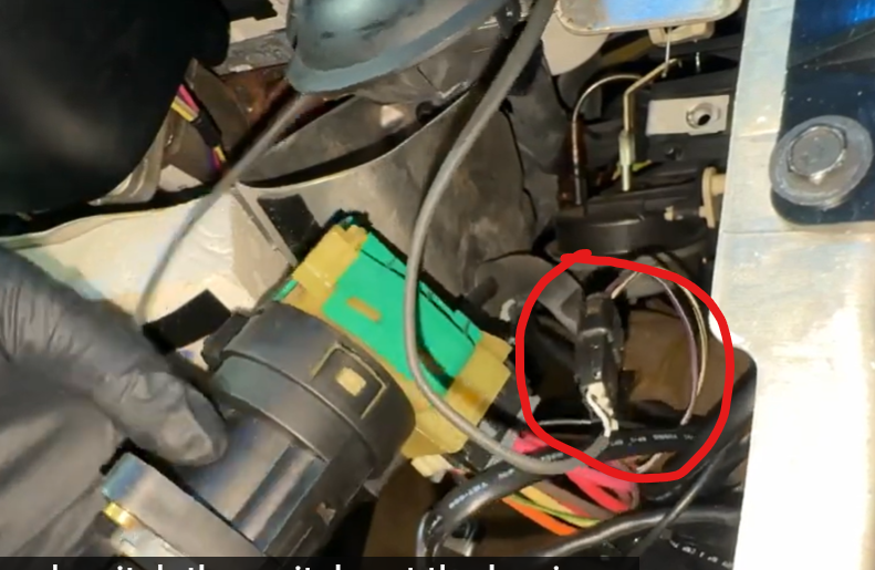

I recently took my dash off to replace both a/c actuators. Everything is back on except for the dash, I took off the hazard switch off the dash and plugged it in the car. The car won’t start, the ignition turns on but it won’t crank. Does anybody know why?

Did you disconnect the lock cylinder connector when you took everything apart?

To the OP, did you or did you not plug the small two wire connector from the lock cylinder onto its mating connector?
