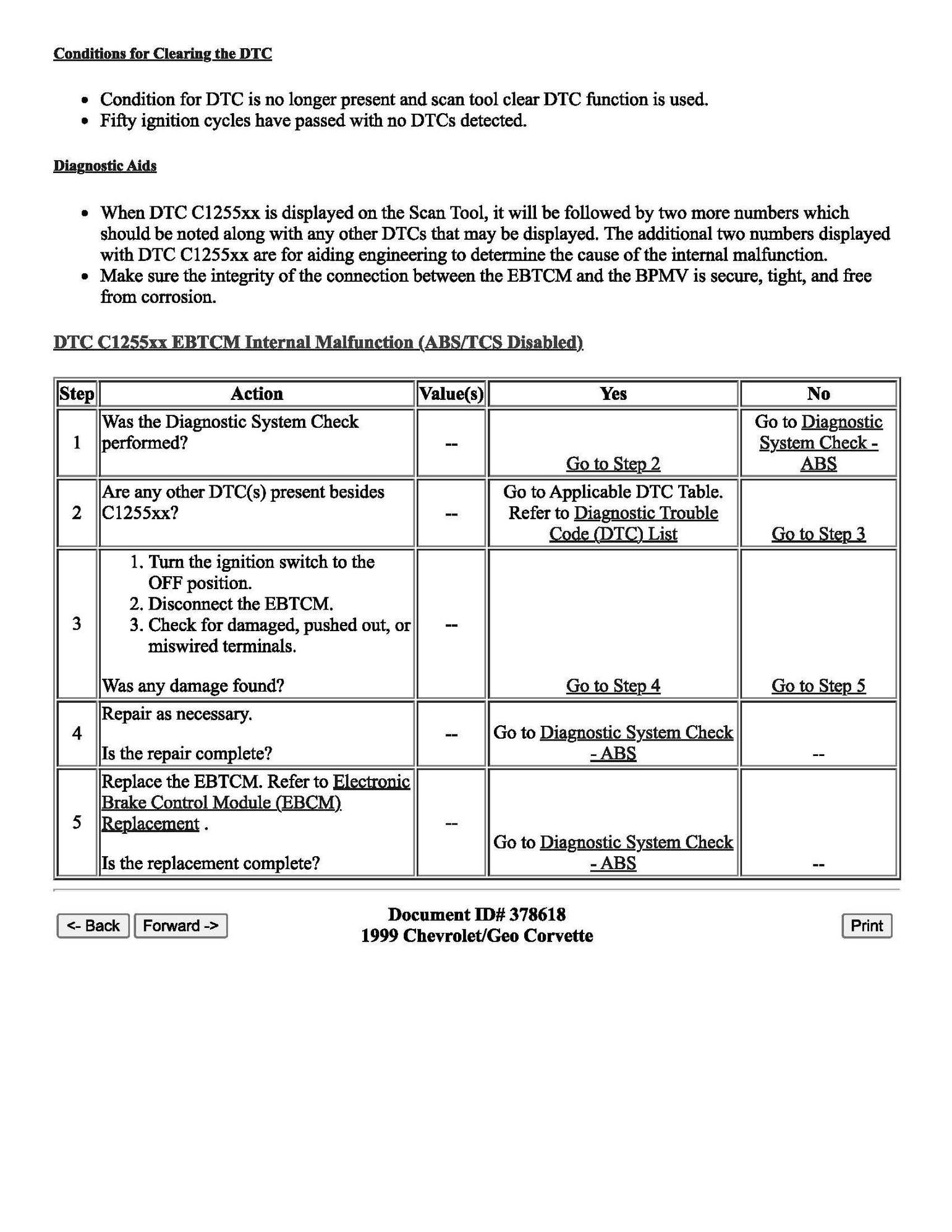

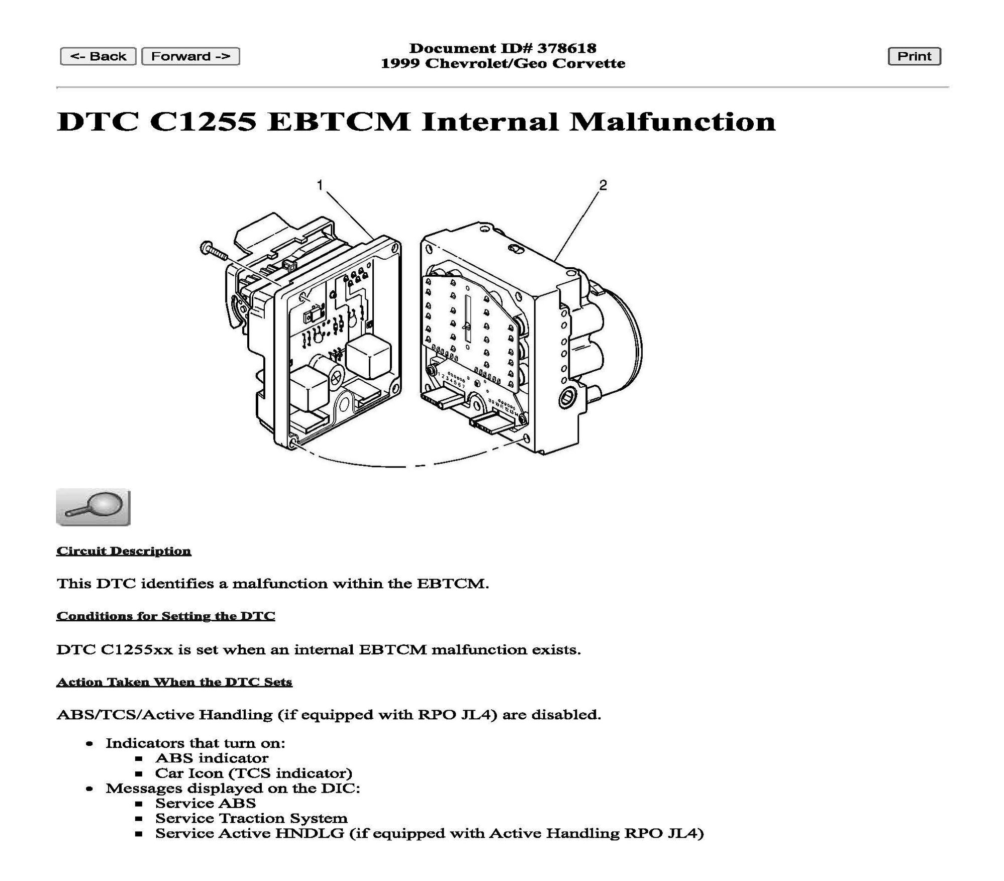

What is code C1255?..................How do i fix this?..............

Your EBCM is fried. Can not be fixed. Only ones available is used and not guaranteed. Minimum 1500$
