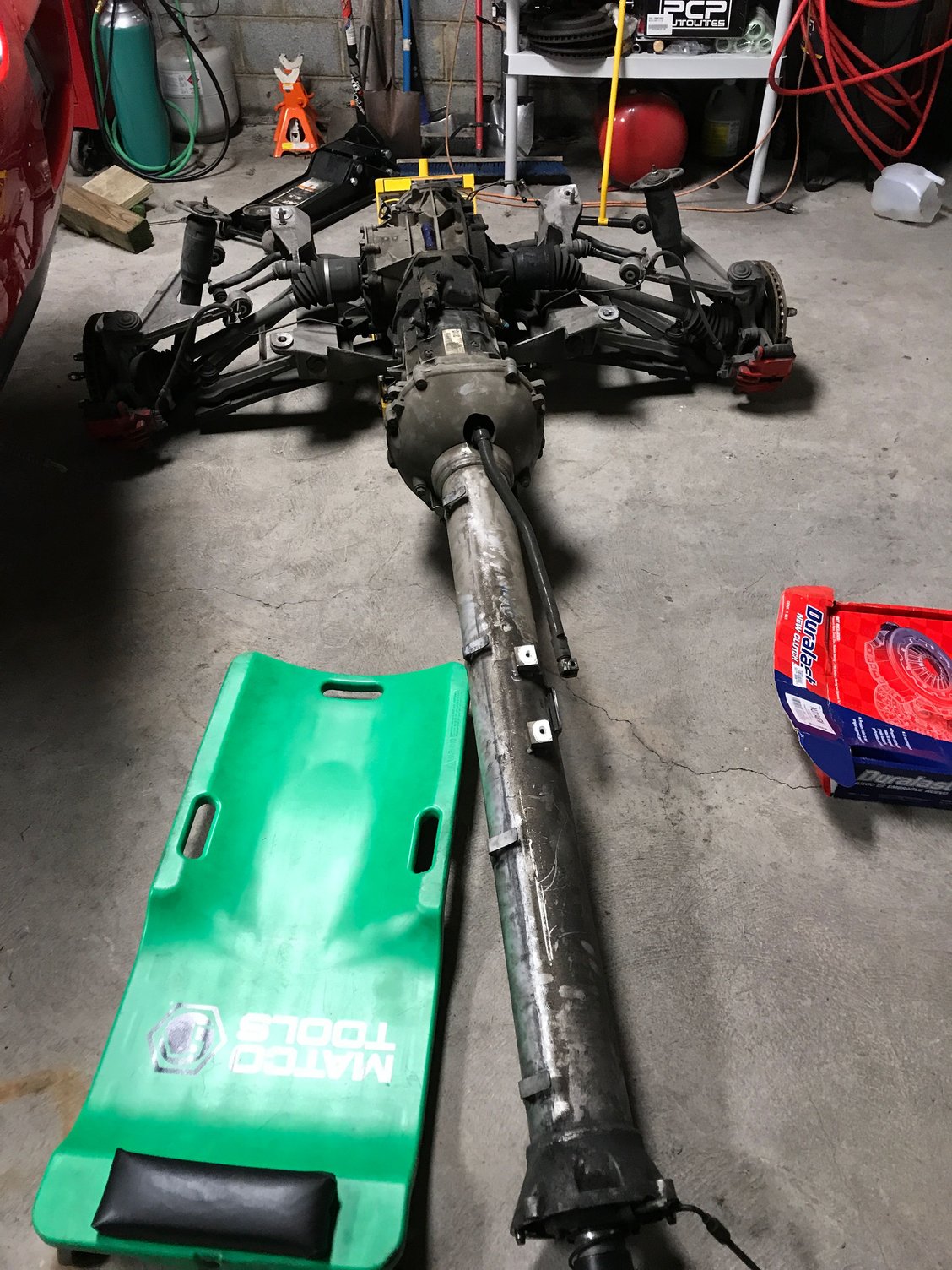

With a lift and tranny jack, a clutch job is not that bad. this pdf write up was done on jackstands, at least you know what your getting into

Don’t even need a lift I did mine on the garage floor with some ramps.
