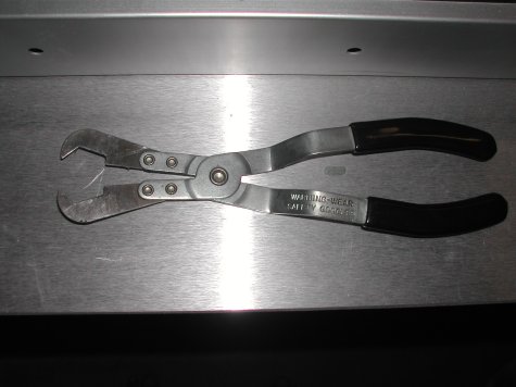

Yes, there is.
Last week I went to remove a couple of plugs just to check their conditions. When I realized I wouldn't be able to remove the boots without breaking them, I called a mechanic friend, who said he had A Snap-On tool designed for just that, and I borrowed them.
Unfortunately, the Snap-On tool is of a design that requires you to be able to fit the entire length of the tool in the engine compartment and pull head-on, which is not possible in a C5. The grabbing end is also not quite what C5 owners need, in that you can't get a good bite on either the boot or the heat shield.
Frustrated, I went to my toolbox to see if I could rig something up. Take a look at what I found staring me in the face when I was sifting through my pliers drawer:
Unbelievable! This gem clamps around the end of the boot, and even fits right into that little groove on the end of the boot, and since you basically grab the boot from the side, it fits perfectly in the engine compartment. It is also thin so it can get into tight places. Although I bought it somewhere between 1983 and 1985, it was designed specifically for the C5!
Don't ask me who makes it because there is no manufacturer's stamp on it or anything. The stamp you see in the pic only says Warning - Wear Safety Goggles. I do know that I got it in either Centereach, Selden or Farmingville, New York, out on Long Island, from one of the franchise auto parts stores there, but I can't remember the name. Maybe some 'gIslanders can help us out, heah(couldn't resist).
I don't remember how much it was, either, but I think it's worth about $2000 right now!
Wow!!!
Let me try to look around to see if I can find one!
Nice tool!

I have one of those that is coated at the ends with soft rubber. Unfortunately, not sure where I got it. I may have got it at the Sears automotive section.

Originally Posted by angryfly
Wow did a searck on Snap-On's site for "spark plug boot pliers" and it came up with 6 different styles.
The only ones that MIGHT work are these:
http://buy1.snapon.com/catalog/pro_d...re&dir=catalog
You can't really see them, but the reason I say this is because the plastic coating seems to make my friend's tool slip off the boot as you tug, so if those coatings on the ones referrenced above aren't removable, you're hosed. Also, even with mine I have to use two hands so they have to be the right kind, and really should be able to grab the groove on the boots without pastic on the pliers to work well.
Oh well, at least we know we can keep looking online. Someone's bound to have something somewhere.

that tool used to take off door handles, you can get one from summit, pt number sum-w80647. 6.95..............
Old Sep 17, 2004 | 02:02 PM
MrLeadFoot's Avatar
MrLeadFoot
Joined: Jul 2004
Posts: 2,340
Likes: 35
From: Folsom Lake CA
Yes, yes, yes! I was wondering why I even had those! I remember now. I had a cherry 68 Camaro SS, and didn't want to screw things up in a car like that. I now seem to remember using that tool to remove the retainers behind the vent window cranks.
OK, everyone, new search is in order! Oh, wait...you already did that for us.
Thanks!
Edit: Where can we find more info? Got a web address? So far, even trying to search for that part number yields no results.
