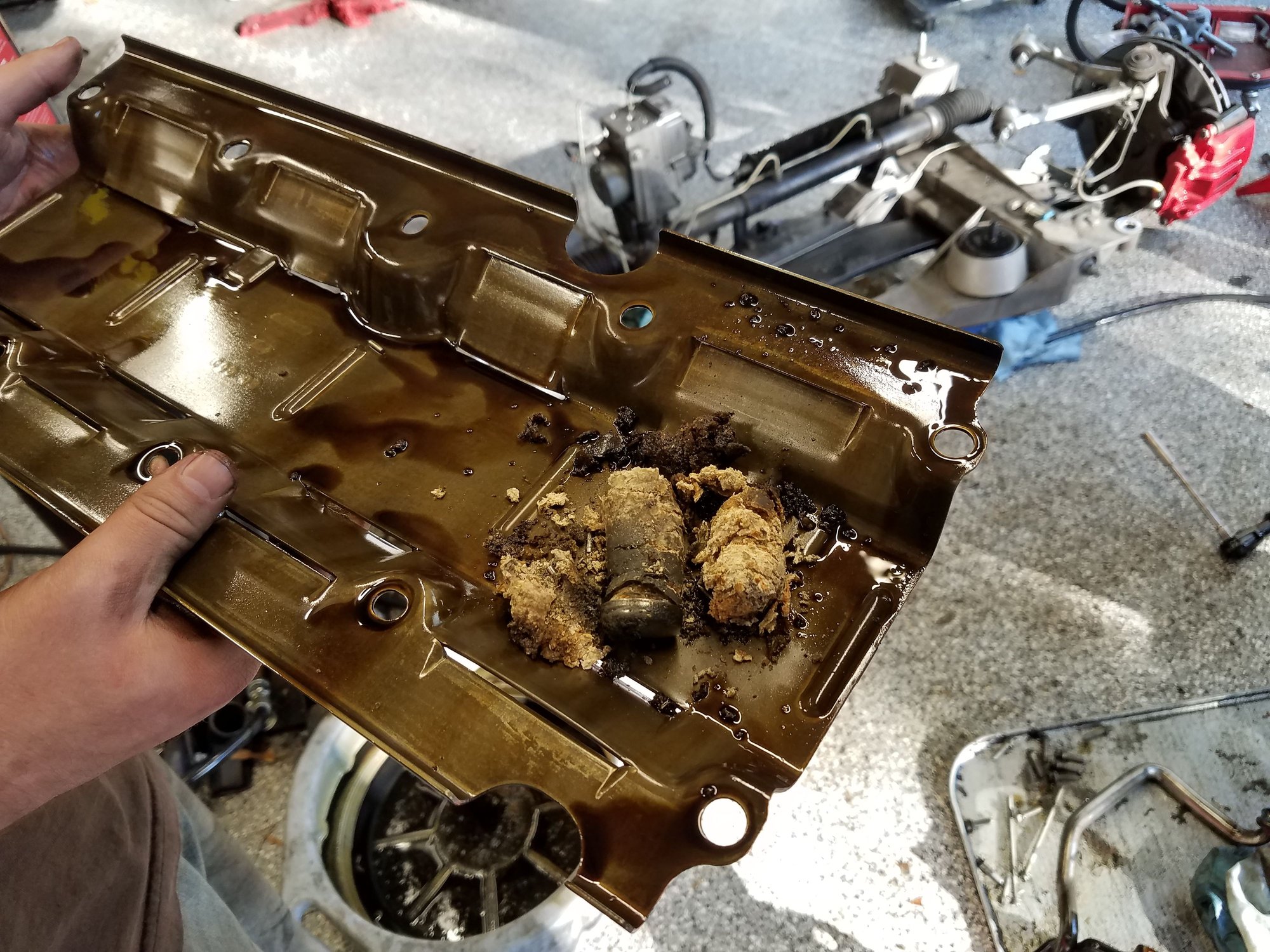

Can you elaborate more on this oil seal “in the end of the crank”… think I might have pushed mine out/in while trying to do the bread trick method to get the pilot bearing out… -__-

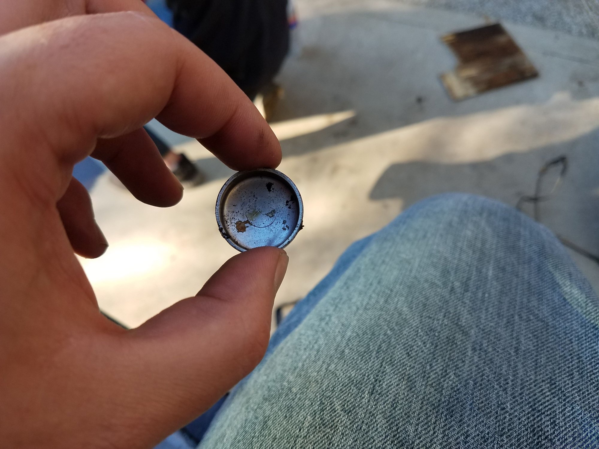

This thread is ANCIENT but yes you did do that. I know because I also did it using the bread method. HUGE MISTAKE. For others NEVER DO THIS!
You have to drop the front subframe to drop the pan to get the mess out now I'm sorry to say. Dorman sells the plug you pushed in. Its a freeze plug looking disc.
