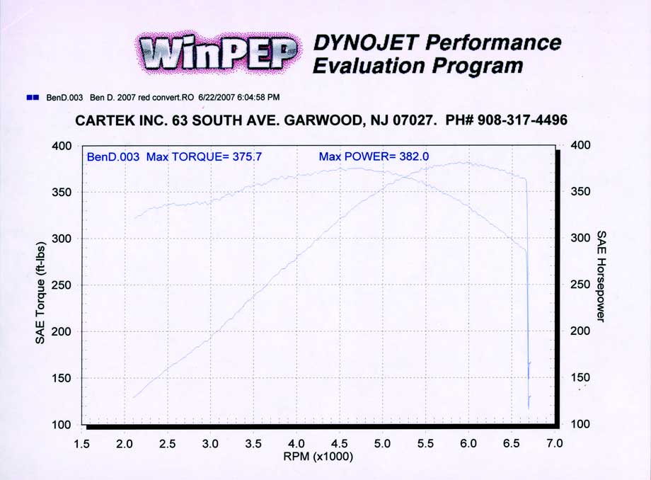

After putting on a few hundred miles now, I'd have to agree that they are louder, even on the stock exhaust. Not at idle, but when you get it on it, it rips a bit.
Here's the result of adding Kooks headers w/high flow cats, Callaway intake, 160 'stat and tune at Cartek.
I'm going with same set-up but with Dynatech headers next week.. What is the seat of the pants effect??
I'd really like to say that I could feel it, but the difference between 400 HP and 428 HP isn't something my bottom can feel. I've just barely got 1000 miles on the car now so I'm too new, I think.
-Ben
I understand. By the way, I think you may have 42 extra horses now.. instead of 28.. nice vert by the way
-Ben
I watched Ben's pulls. Great sound. WIth only 500 mi Ben, you're bearly broken in. I would expect that you'll pull another 5-10 @ 2.500 mi when she's fully broken in.
I like the sound of that, but I don't get your math. Can you explain that a bit? If it matters, mine is a manual.
