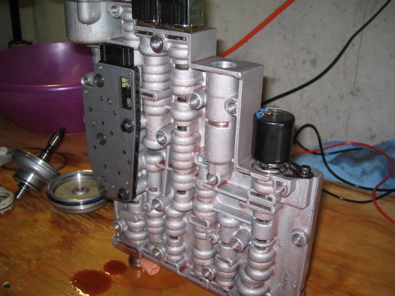

All of the Corvette automatic transmissions have a control module mounted on the valve body of the transmission. It is called a PSM (pressure switch manifold). The purpose of the PSM is to electrically confirm that the shift has mechanically taken place. If anything was done in the valvebody to allow more fluid pressure then the PSM would need to be changed to accomodate this change.
I can't imagine that they could make the transmission shift faster without changes to the valve body and subsequently changes to the feedback module (PSM).

No, we're talking about two different things Chuck. There is not anything "tuneable" on the PSM. It is an electromechanical switch that mounts on the valvebody. The only thing it does is open or closed at a given pressure. The only way to change how it operates is to change the pressure disc (snap acting disc) mounted to the bracket. I used to make these for the supplier to GM Powertrain. This is a PSM:
Here it is in it's brand new state. These are mounted to a plaque I received when I left this job.
Here it is in the transmission:
and the other side of the valvebody:
