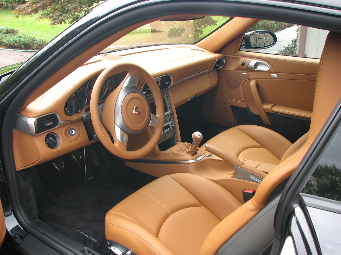

Vinyl??? Bwah, ha, ha, ha!!
For comparison, here is what actual leather looks like:
To C6 interior issues ??
Old Oct 6, 2008 | 09:01 PM
  #38
harddrivin1le's Avatar
harddrivin1le
Posts: 983
From: CT
Damn straight.
I'd take a decent cloth over the "leather" in my C6 any day of the week and I'd gladly trade a well constructed, fully MANUAL seat for the "8 way power" features in these seats. They COULD offer such a seat for the same $$$ as what they're offering now, yet they don't.
