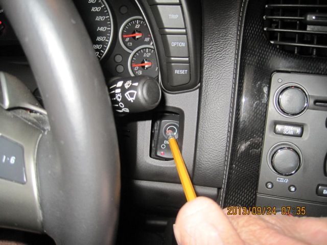

To Help! Start button problem
Old May 3, 2014 | 08:11 AM
Arkay's Avatar
Arkay
Joined: Apr 2000
Posts: 2,767
From: Austin TX
Originally Posted by vette4life79
Help! My start button caved into the dash. I need to know how to remove the dash to put it back in place so I can start my beloved 05vette. Anyone have a link that shows how this is accomplished? Thanks a million.
Been there done that and this is how I manage to get home
