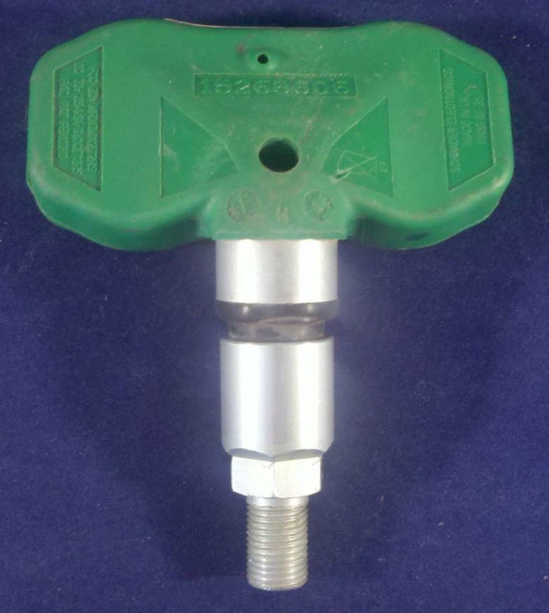

BTW, just to throw out some more info for anyone reading the thread that isn't aware of it:
The GRAY sensors in the pictures in previous posts are for a 2005-2009 C6. They are GM Part# 25758220.
Check out the picture below:
The GREEN sensor in the picture above is used in a 2010 or newer C6. It's GM Part# 15268606, and you might be able to see that number molded into the case of the sensor in the picture.
You must use the proper sensor for your model year or it just won't work - you can't program the sensor into your TPMS unless it's the correct model for your C6.
The TPMS computer in the car can hold 4 sensor ID#s, so if you put new sensors in your wheels, or have a couple sets of wheels/tires/sensors such as for the track, you must program the 4 sensors that are currently on the car into the TPMS or they won't be recognized by the TPMS computer.
If you use your current sensors, as is being discussed in this thread, just make sure the tire shop puts them back on the same corner of the car they came off from and nothing at all will need to be done - they're already programmed in.
If the shop mixes them up and they go on different locations than they were programmed for initially, they'll still work - but the DIC display of pressures will be messed up, i.e. if it says "Left Rear 24 psi" it might be talking about the tire on a different corner of the car. In that case they'll just need to do a "relearn procedure" to program the sensors to their correct location, and it's only about a one minute or so procedure.
Bob
