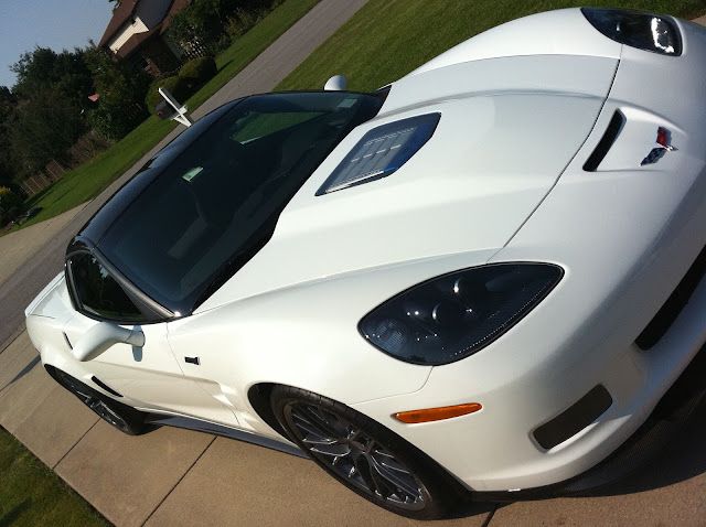

Originally Posted by VetteMark
I cheated and ordered mine with the black headlights. I think contrasting lights for all colors!

Originally Posted by 05dsom
Gorgeous car, that is exactly how id order a ZR1 if I could afford it.
