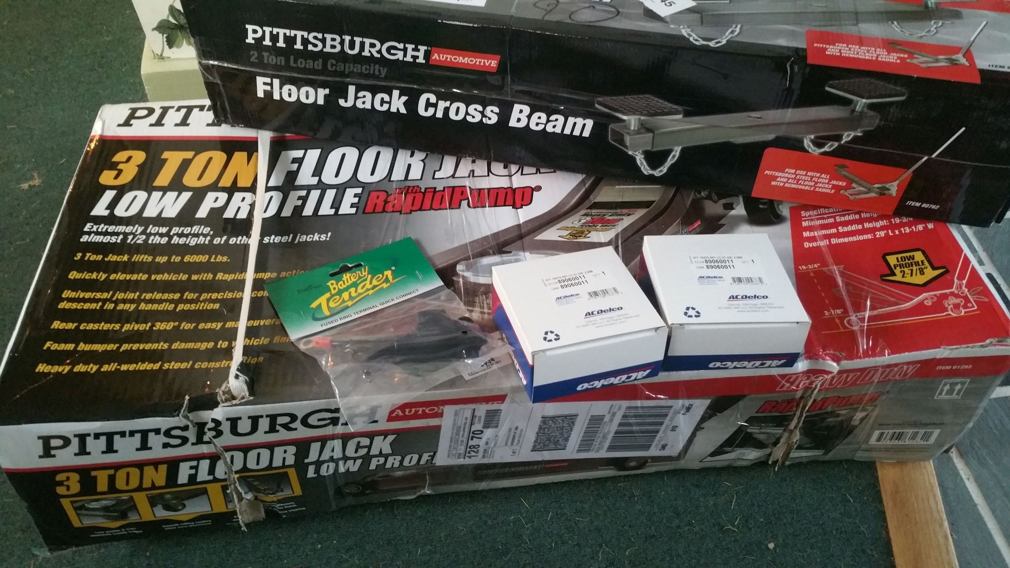

S1lverF0x's Avatar
S1lverF0x
4th Gear
Joined: Oct 2016
Posts: 4
Originally Posted by ez2spd
Its 85° here in Texas! I wish we had snow, none the less I would bet money on your issue being the switch.. after all the weird things we had, replaced switch and all was well once again!
Keep us posted on what you find out!
Brian
Well, the horizontal adapterizer for the low profile jack took the longest of all to arrive, but it's here, along with a nice tender cable, and today is the day.. Just need a lunch break from work! ;-)
2005 reverse light switch(es) replacement kit! (jack stands, wheel chocks and 22mm deep socket torque wrench not pictured)

just waiting on battery to charge from flat-lined again to confirm success!
......tick tock tick tock! (tender only does 1.25 amp , gonna be a while, but since it's now a yellow top, it won't be a dead bucket of electrons!) - Chicken sensor swap-out courtesy of my fiancee who has infinitely more patience than I do, and a much better sense of humor. (much be a Chilean thing)
(BTW, 22mm is _NOT_ correct, though on the OEM switch you can get it about 3/4 over the nut, it is actually a 7/8 deep socket!)
