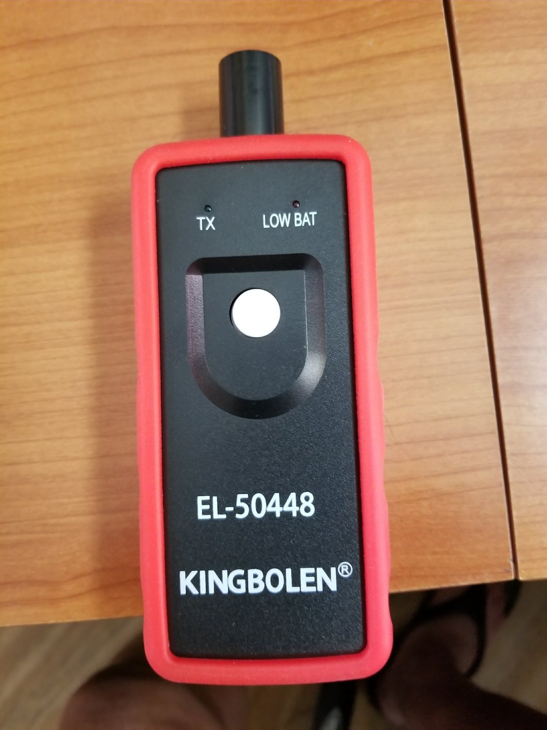

Hi guys - I know I'm bumping an old thread but wanted to take a minute out and say thank you! I've been getting tires and wheels swapped recently so I could get my Crays repaired and found myself with the FL:XX FR:XX message and was bummed about having to go back to the shop yet again. I read this, bought an inexpensive TPMS reset tool from Amazon, (was literally $13 bucks) followed the procedures above, and it fixed me up.
I was able to do it by using Accessory mode, looks like there was some back and forth about what mode to be in. Then just went around to each tire and when the horn beeped once went to the next one. When I did tire number 4, the horn beeped twice, I turned the car from Acc to Off, opened and closed the door, then started the car with no error message displayed and tire pressure readings all around! woohoo
I bought this one and it arrived at my door the very next day.
EL-50448
OEC-T5
Anyway just wanted to say thinks to my fellow Corvette brothers for being so helpful, this site allows a dude like me to own a car that still makes me smile every time I walk up to it in the parking lot!
Thanks,
Nick
