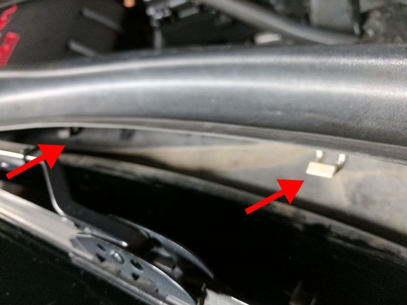

My car, like many others had the 75-80mph "dash" buzzing that I eventually figured out was the outside cowl under the wiper arms buzzing. As many others have clarified, this is relatively easy to identify by the buzzing being reduced by using recirc on the ventilation settings.
Many people say they have found the windshield side rubber flap to be torn from the plastic cowl. Mine did not show that, but the maddening buzzing was still there.
I don't much like to screw with stuff, so I just ordered the updated cowl PN and went to install it today.
On my car, turns out the middle metal snap clip was missing from the front edge of the cowl. Based upon the condition of the parts, the middle clip was never there, and it was just loose enough for the front lip to buzz against the mounting surface. The weatherstripping provides some resistance to this but under enough force it would buzz. Tapping on the center of the cowl without the weatherstripping there made it obvious as the source.
My car was a very early 2008 and I suspect it was just built without the center clip. There is clearly a cut out in the trim where that 5th center clip is supposed to go. I just used a couple speaker mounting clips I had on hand and secured them with some adhesive. Drove the car and the buzzing is gone.
I could have checked for this in 2 minutes by simply removing the front weatherstripping and it would have been obvious. It would have taken a $0.50 metal clip and less than 5 minutes to replace, vs. a $80 part and 20-30 minutes to replace removing wiper arms and a couple other trim parts in the process.
Bottom line if you have this buzzing and the rubber trim is not torn, pull your weatherstripping off and check to see that all 5 metal retaining clips are there. Don't do what I did and waste money and time.
Chances are if 1 car was built like this, quite a few of them were.

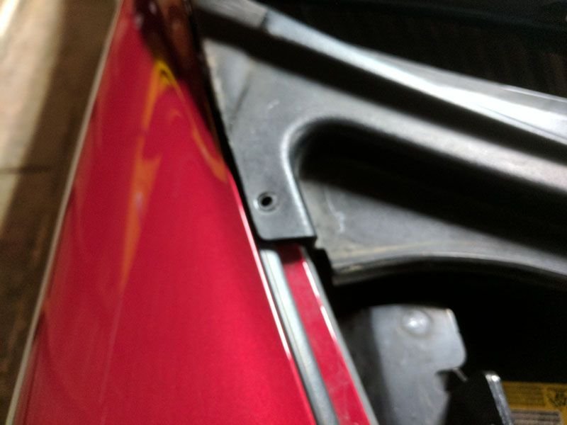

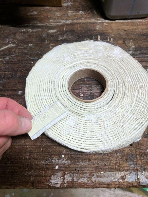

Originally Posted by PDsVettes
Thanks, I used this bulletin while fixing my cowl today. I've posted a few pictures, for what it's worth.
1. Remove the torx screw from the driver's-side, plastic inlet and prop it up.
2. Remove the torx screw from the large, plastic windshield cowl on the passenger's side of the vehicle.
3. Remove the the rubber hood seal. (It's the contoured piece of rubbery foam that snaps in place and spans the width of the vehicle.) Now remove the 4 exposed metal clasps on the front-side of the large cowl that hold it stationary.
4. Gently separate the large cowl from the underside of the windshield. There are five plastic underhooks that hold the cowl in place. I was able to separate most of the cowl and reveal 4 of the 5 underhooks. (I couldn't expose the middle one without fear of breaking it off.) The images below show the exposed underhooks.
5. Use butyl tape, or an equivalent, to wrap each exposed underhook, such that when the cowl is snapped/forced back under the windshield, the underhooks will be less prone to vibration. I used about 1.5" to wrap each underhook. (Before wrapping, I did my best to clean each underhook with mineral spirits, so the tape would stick better.)
6. Here's one of the underhooks, wrapped in butyl tape.
Like others, I noticed the thin, rubber piece that lays flat against the windshield had separated from the cowl in one section, about 8" in length. I used Gorilla tape on the underside to hold the rubber piece to the cowl. (Be sure to wipe the underside of both pieces with mineral spirits or something equivalent, so the tape will stick.)
Before I performed this 30-minute job, the buzzing was heard at speeds over 60 MPH, but now I don't hear anything.
Hope this helps.

Image below shows the snap clip locations. There are clearly 5. One could also make a strong argument for running a small bead of silicon between the two flat surfaces the clips clamp together. The weatherstripping pulls right off, it is not bolted or glued, only held on by the shape of the weatherstripping.
I did a decent amount of internet research before going out to buy the part. I wonder how many people that have done this even notice how many places there are for snap clips. I betcha more than a few have been replaced with that missing clip being the actual root cause, and they just happen to buzz less due to being a new (stiffer) part. Double sided tape or RTV would do the same thing, stiffen the part up just enough to stop the buzz.
The problem here is that I can see the same part has two different failures that cause a similar noise. If the rubber strip fails, then the cowl will be free to float due to a loss of pressure and will buzz. If these front snap clips are missing, then the assembly won't be as stiff and will buzz. The AC recirc setting matters because it influences airflow in that area. Having the fresh air port open must create more turbulence that excites the cowl.
The good news is that the problem is very easy to diagnose as this part with the recirc/on-off test at speed, and you can check for the missing clips in seconds with no tools, same as you can check for the rubber flap being torn. This is just one very simple thing to check before messing with sealants/RTV/tape or buying a new part, and something else to make note of if you are replacing one with a torn flap.
Those that have this problem know it must be fixed. That goddamn rattling was driving me nuts, it's not a small GM-like rattle or squeak. I can now drive ~75-85 again to keep up with Michigan highway traffic.
