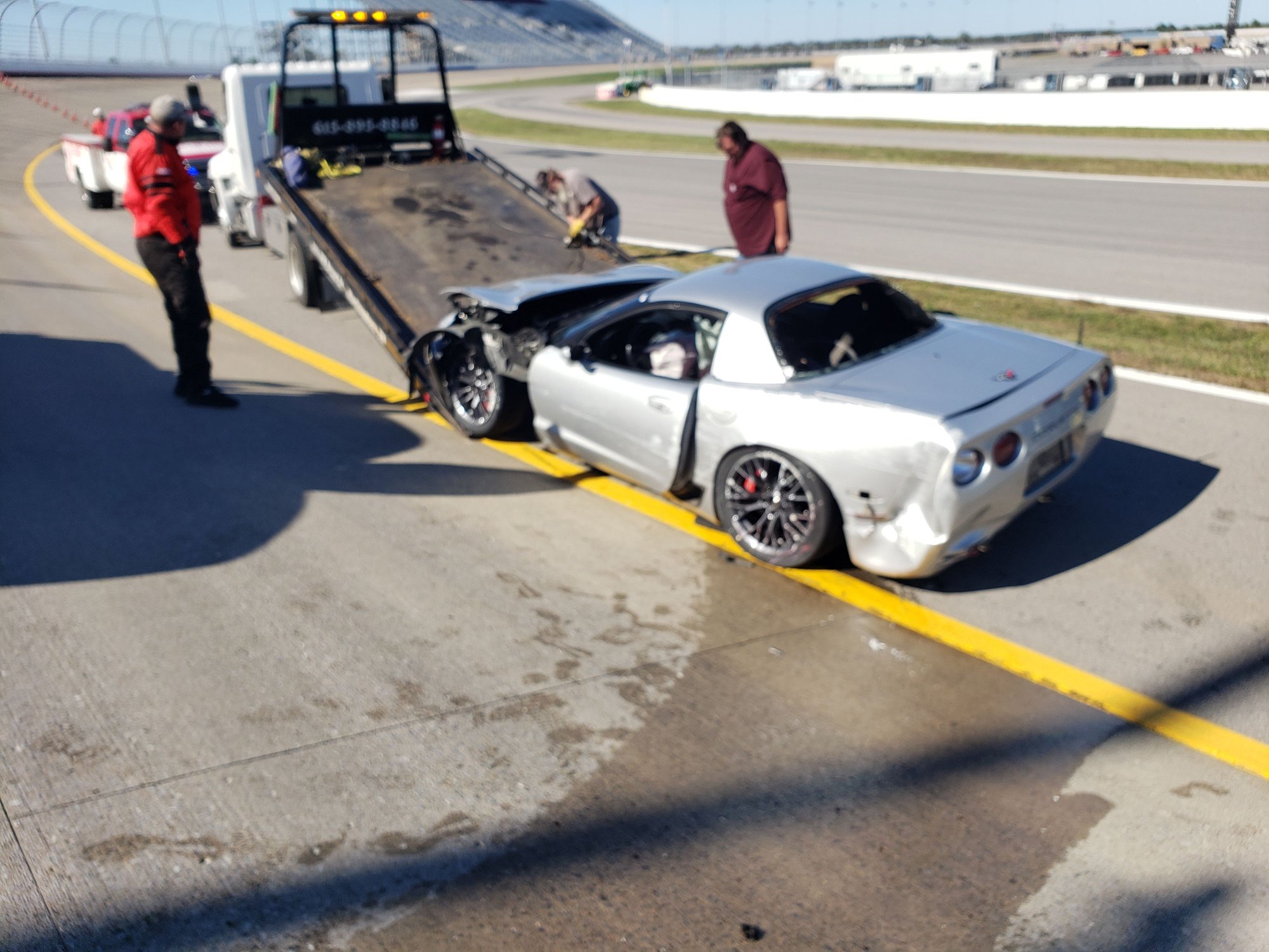

This happened to me on the track. Going down the front straight at Nashville International Speedway. I was going over 150 mph and was about to turn into the infield when the car started dinging. I briefly glanced at the console, it said service active handling soon and I completely lost control. Hit the wall at about 140. Totally destroy my C5 Z06.

If going to run a Vet on high speed track, need to run active handling in comp mode at least.
Running it in street mode (all nannies on), has the active handling/yaw sensor reading to sensitive, and will kick in AH to try to keep the car straight, when your putting the car into a corner at higher G rate. Hell, the amount of times I have see newbies try to run a hot lap with all nannies on in the vets, end up with car not turning into a corner/off track since AH has kicked in to not allow the car to turn but to try to straighten back out going forward only, way, way too many times.
If you are really pushing the car, do have the talent to skate the car and keep it in check, then screw comp mode, and just run the car in all nannies off, where the only thing left on is abs. With comp mode, AH will still kick in if back end gets too far out, while in all off mode, back end is free to come around on you without anything trying to save you/get the car straight going forward again.
