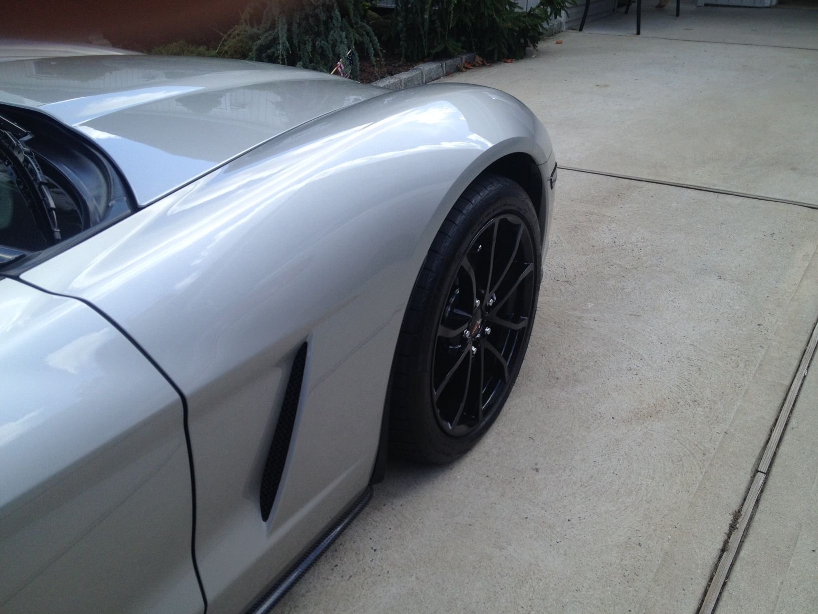

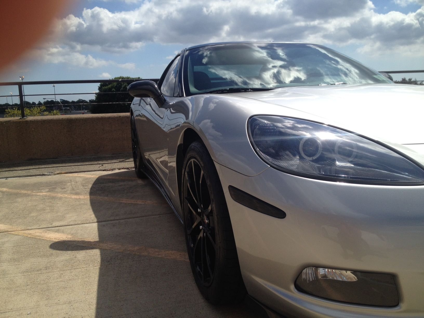

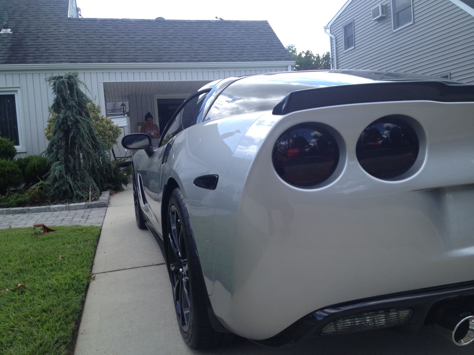

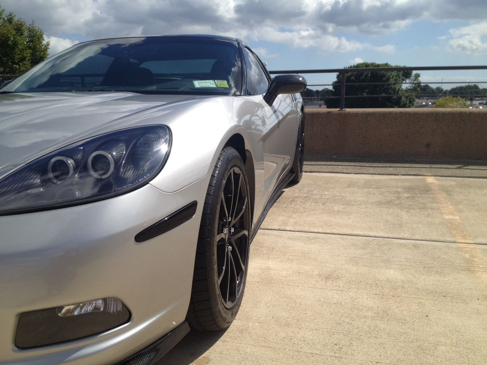

We need to see a pic of the car with flush wheels.
Old Oct 30, 2014 | 12:28 PM
gp56's Avatar
gp56
Joined: Feb 2010
Posts: 1,394
Likes: 19
From: Levittown NY
This is all I have available here at work
Old Oct 30, 2014 | 12:46 PM
Bat66's Avatar
Bat66
Joined: Dec 2012
Posts: 525
Likes: 21
From: Houston Texas
Looking good gp. Thanks.
