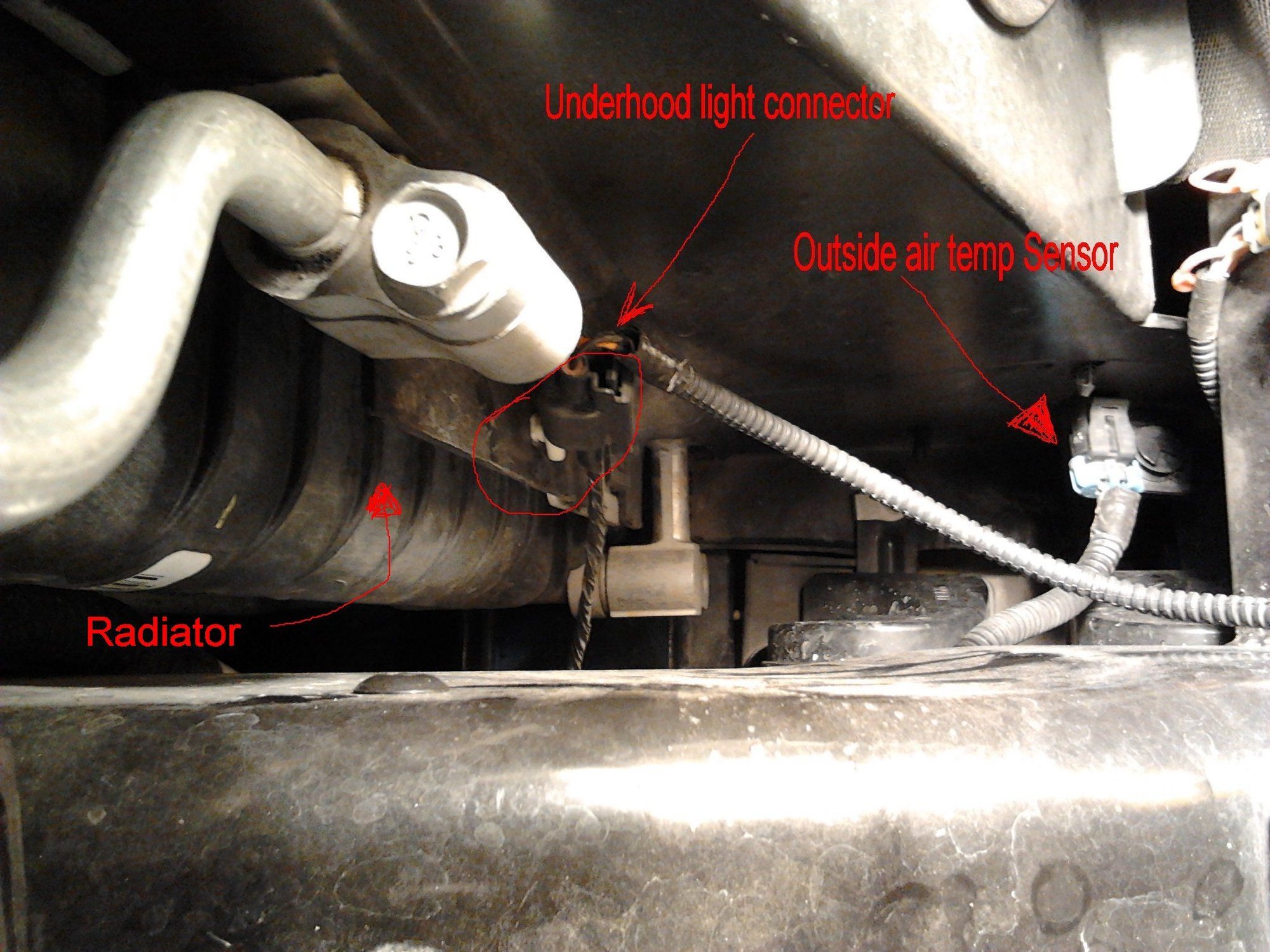

Thanks for everyone's help. it was the outside temp sensor. Now for the mystery of buying used, car has 9K miles.. I can't find the sensor at all, looking everywhere it should be. I happen to be digging around by the horns and found the sensor wiring uplugged and sensor missing. While at it, i notice the horn wires had be been sliced with butt slice on t the two wires going to it. I have not idea what this is all about.
Anyway, sensor is replaced, $10 part with next day shipping. cant imagine what i might find if i keep looking.

Glad you were replace the outside temp sensor. Seems strange about the horn wiring.
I've added a few pics of the sensor location (pic #1) and how it is held in to the plastic panel so other forum members can get the info.

Hey TOUR great Pics! Thanks, those will help a lot in the future!

the top pic was how i found it. I looked everywhere and since it was not there i was completely lost. Then started feel around for wheel wells and found the loose plug with no sensor attached.
Very strange indeed about the horn wires being sliced. not sure what that was about. And i still dont get why anyone would just remove the sensor and never replace it. its likely the cheapest part on the whole car.
