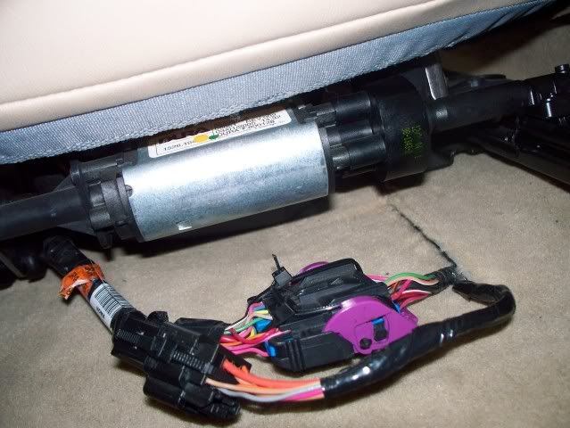

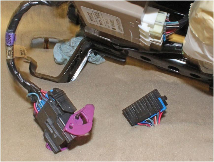

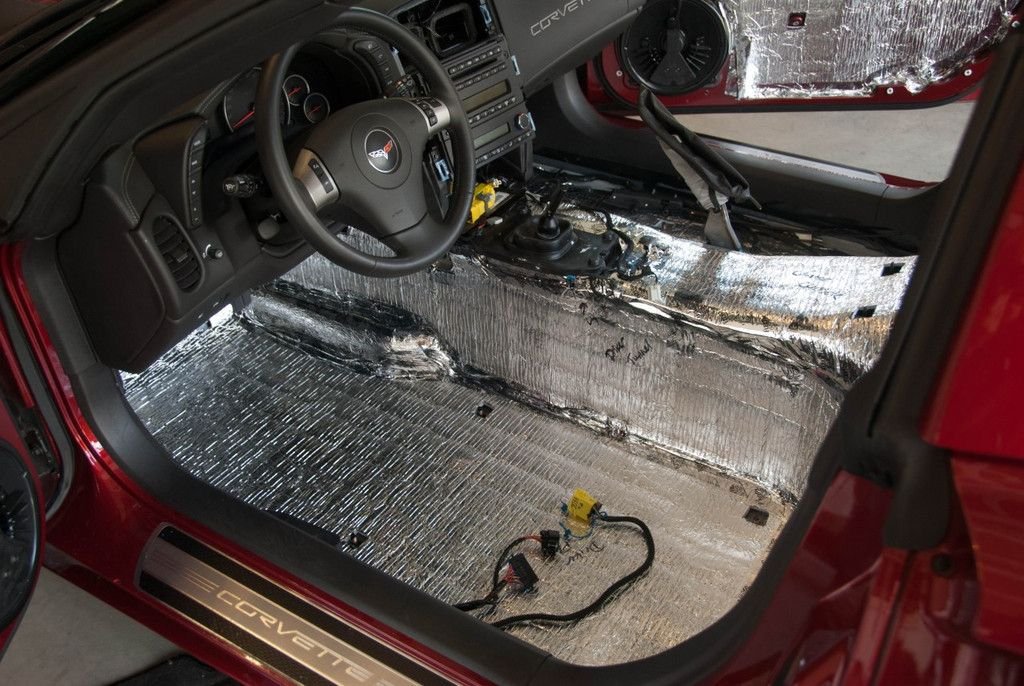

Here are the pic of the driver side with seat removed, showing the wiring connectors that go under the carpet/seat. There is limited space under the seat, so that can cause the connector to loosen because of friction, if the connector is not held tightly in place. That is why a tie wrap works to keep the connections from becoming loose, or disconnecting.
Now this is a pic of the connectors under the seat. The wiring under the seat is long enough, but the one under the carpet is too short.
Zip tied connector
I guess the wiring could be rerouted, but it would have to be rerouted straight back behind the seat, then over to the side of the floor pan by the door.
I'm sure someone may have the nerve to cut the wiring, but the zip tie method is not a bad 2nd option to keep the connector tight.
