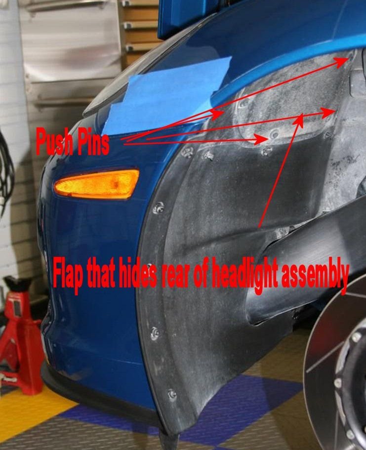

2) remove the push pins of the flap that is high on the plastic liner, in front of the wheel.

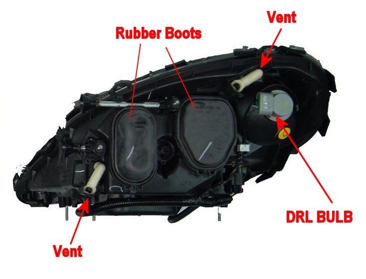

3) Once the flap is removed, you will notice the (2) rubber boots) that cover the headlight bulbs.
4) Remove the (2) boots, then use a hair dryer to force heat into those opening until the moisture has been evaporated. It only takes 5 minutes or so.
When you have the headlight clear, re-install the rubber boots, and re-install the flap with the push pins. Install the wheel, and you are done.
There are a few things to look for, if you get that much moisture in the headlights.
1) Those rubber boots that cover the headlight bulbs could of fallen off, or are loose, thus allowing water to enter.
2) Check that the DRL bulb ( outer) is tight, and the rubber seal is OK.

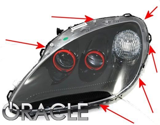

3) If those 2 things are OK, then the only other area water can get in, is between the assembly and the headlight lens.
It's possible that the glue that hold these 2 pieces together has failed, or was not done correctly from the factory. (that was my issue)
Water could work in there under heavy rain, or when I went through a car wash under pressure.
I solved this issue by using a clear silicone sealant, and went all the way around the headlight, making sure that the gap between the assembly and lens was filled.
To do this, you need to remove the headlight from the car, and may need to remove the headlight gasket, in a few areas to get access to that gap, all the way around.
I've enclosed a pic of the headlight assembly to show the different areas that could let water in.
Headlight assembly gap that may be leaking

It's easy as 1-2-3 to remove the pins and flap
Thanks! That's a good picture. I need to shine a light under there and then I'll see the flap better.
Mike
Reply 1
Jan 19, 2015 | 04:45 PM
Quote: Thanks! That's a good picture. I need to shine a light under there and then I'll see the flap better.
Mike
Post #10 does show the area on the passenger side with the flap removed.

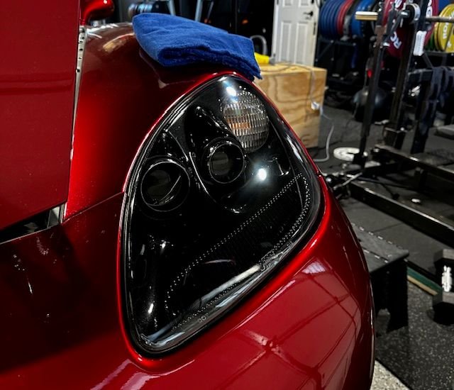

Jan 19, 2015 | 10:48 PM
Headlight is now spotless
Reply 0
Jan 19, 2015 | 11:23 PM
Quote: Headlight is now spotless
very nice ride. Your headlight looks alot better

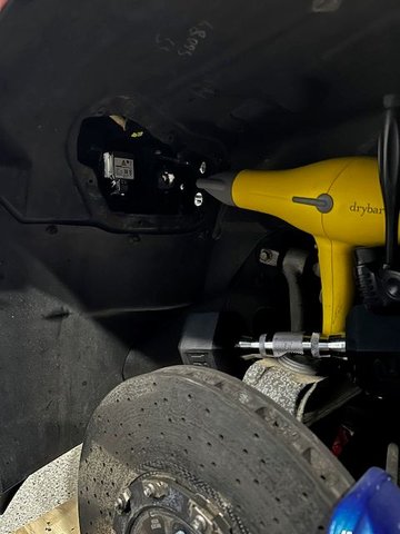

Jan 11, 2025 | 05:20 PM
Quote: I've seen that much moisture in my passenger headlight before, and I did find the reason, and how I fixed it.
1st, to get you through the ordeal, and dry out the headlight for the car show.
1) jack up passenger side and remove the wheel.
Hope this helps.
Sorry to revive an old thread but want to thank you for this. Followed the steps for drying it out, hopefully that is it but will see the next few times I drive.
