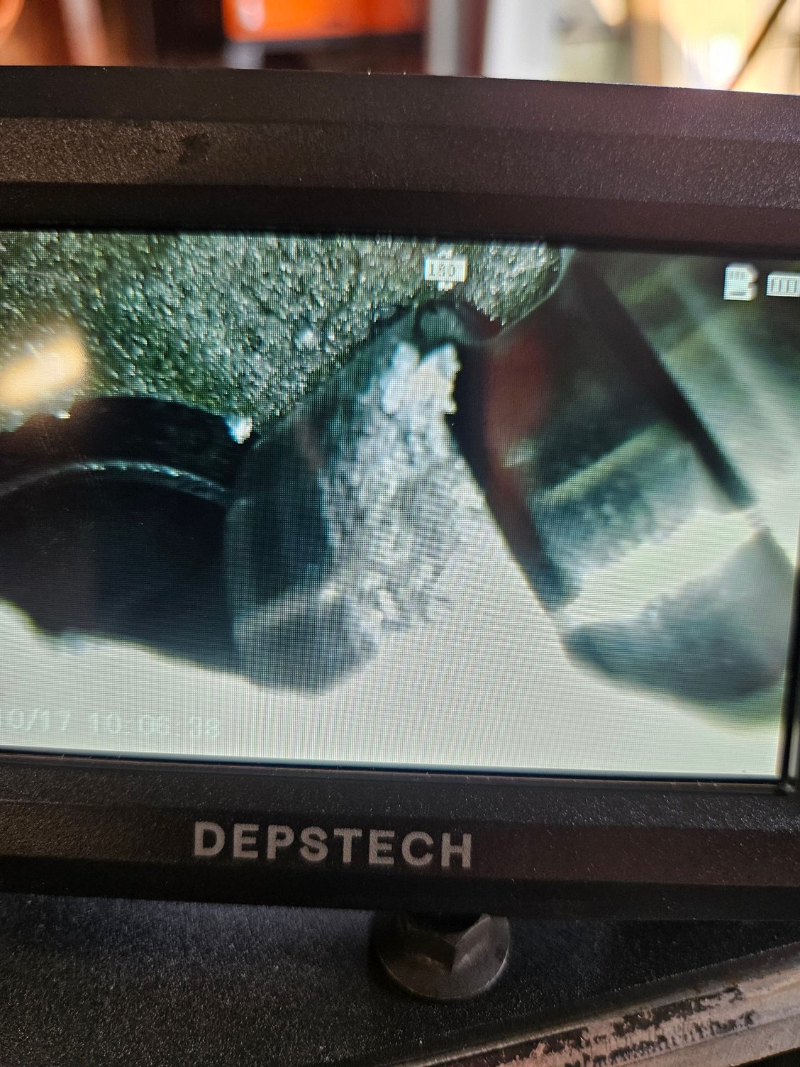

Welp with only 45k on the clock I'm almost certain I threw a rod. Started tearing down the top end yesterday. Going to get the heads off this weekend & make sure I didn't drop a valve but from what I heard getting off the highway sounded like a rod. Anyways I've been trying to contact this company called S&J engines but haven't gotten a response back yet. Wanted to just buy a remanned/rebuilt 6.0. S&J offers them & upgraded options like port and polish heads, balanced crank & melling cam options. Would be around 6200ish. Was looking on ebay, they have motors for about 5 to 7k with as low as 32k miles and some with 103k. Anyone in the US that knows of some good places to buy rebuilds let me know & would be appreciated. Also not sure as I've never replaced an engine in a chevy if I bought a new stock everything rebuilt would my pcm & ecu work or would I need to get it "tuned"? I've cammed & built the top end of my 5.7 hemi but took it to a dyno shop & had it tuned. Not sure if I just buy a stock motor with 24tooth reluctor if I could just swap everything over plug in and go?

If the only thing damaged was a rod bearing I'd just have it freshened up by a local machine shop and reuse all of the same parts.
About 7 years ago the rod bearings on the LS7 in my race car were going out every 4-5 months due to a combination of several underlying causes. Once the issues were finally resolved and I put it all back together it's been going strong for just over 6 years now. Even while hotlapping the car on extremely warm days I never see below 38psi of oil pressure at idle.

You guys have way more confidence then me lol. Engine shut down when I got off the highway. Had to tow it home that night. Luckily I had straps and a truck but it was completely seized. Tried turning it by hand but it will not turn. crossing my fingers that its a spun bearing but the sound I heard sounded like i dropped a valve. I haven't seen the exhaust side yet but all the intake valves are up. Hell if I do get lucky might just be a failed lifter but the bad luck side would be it wiped out my cam & seized itself to the lobe. I have alot of speculation but I'm leaning towards a rod. Unfortunately I'm working 10hrs a day so I don't have too much time to mess with this after work but hopefully I'll get some time Sunday & get the heads & oil pan off.
For under $25 Amazon sells a borescope camera that attaches to your phone. This will let you make a quick and dirty assessment by looking inside each cylinder to see what you're dealing with. Chances are though that if it was a dropped valve you won't even be able to get the spark plug out.

Ok pulled her out today. Pita to say the least. Lifter failed & wiped out cam lobe which in turn exploded the timing chain. Seems like a 5.7 hemi issue. Sending the engine off to S&J engines to get remanned. Turn around is about 8 to 10 weeks. Total cost with new clutch kit, lightweight flywheel, torque tube bushings, & other misc gaskets & fluids is about 6k to 6500. Hoping they don't find cracks in the block from this.

Yeah that's what i thought but some of these shops are telling me later 2005 ls2 had vvt/dod/afm. My timing cover is flat, my valley cover is flat & lifters are completely normal. I did pull the timing cover off today. Warning this is a graphic picture. I'm going with my theory that the lifter wiped all this out. Completely snapped all three sprockets bolts. Crossing my fingers that the block is still good after this.

Being a Gen 4 it will have provisions but none of the AFM-specific parts. Looks like PTV contact and the cam rocked around in the bearing. Hopefully no more than cam bearing, the 2 valves that kissed the piston and definitely check that rod + crank bearing. Hard to tell if any other contact occurred but no smiley faces on the other pistons on that bank look somewhat promising. New pushrods, timing cover, sprocket, plus everything else already suggested.
