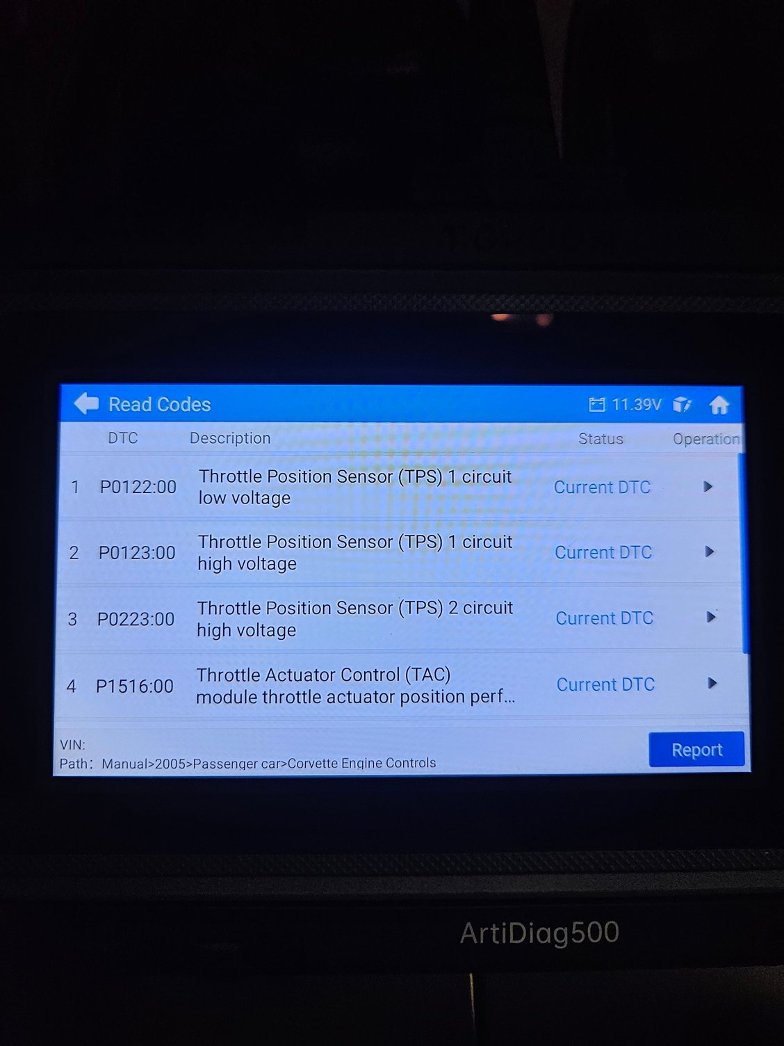

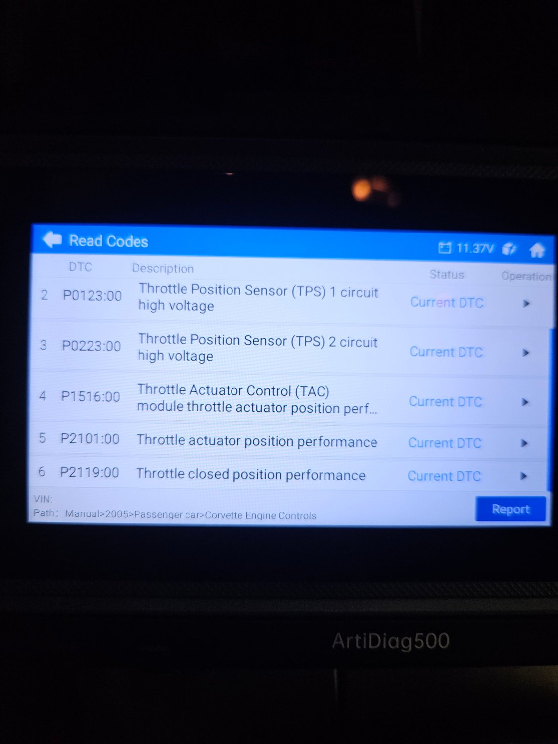

Scanned her before I went to work. Seems like my throttle body doesn't know what to do. When the cars on acc mode i press the gas pedal & the throttle opens 100% & vice-versa when I let it go. It runs fine until it warms up & I let off the throttle & let it idle for a few seconds. I didn't have enough time to mess with the scanner. It'll let me run diags & performance so I'll mess with it more after work. If anyone else has had these dtcs what did you do to fix the issue? Grounds? Plugs?

Ok guys really need some help here. Checked all my grounds & they are all good. Did a throttle relearn on the scanner & didn't help at all. When I clear the dtc it'll run fine for a few seconds but it'll go right back into limp mode & run really rough. When the car is in acc mode the pedal works just fine & opens the throttle body completely. Scanner shows it's working properly but the second I start her up it'll reduce engine power throw the code & ill have to shut her off. Strange thing is it will only start doing this after the car is warmed up. When the engine is cold it's perfectly fine it's only when it hits around 140°. I can't even take her out cuz it will go straight into limp mode. Any ideas on where to go from here would be greatly appreciated.
