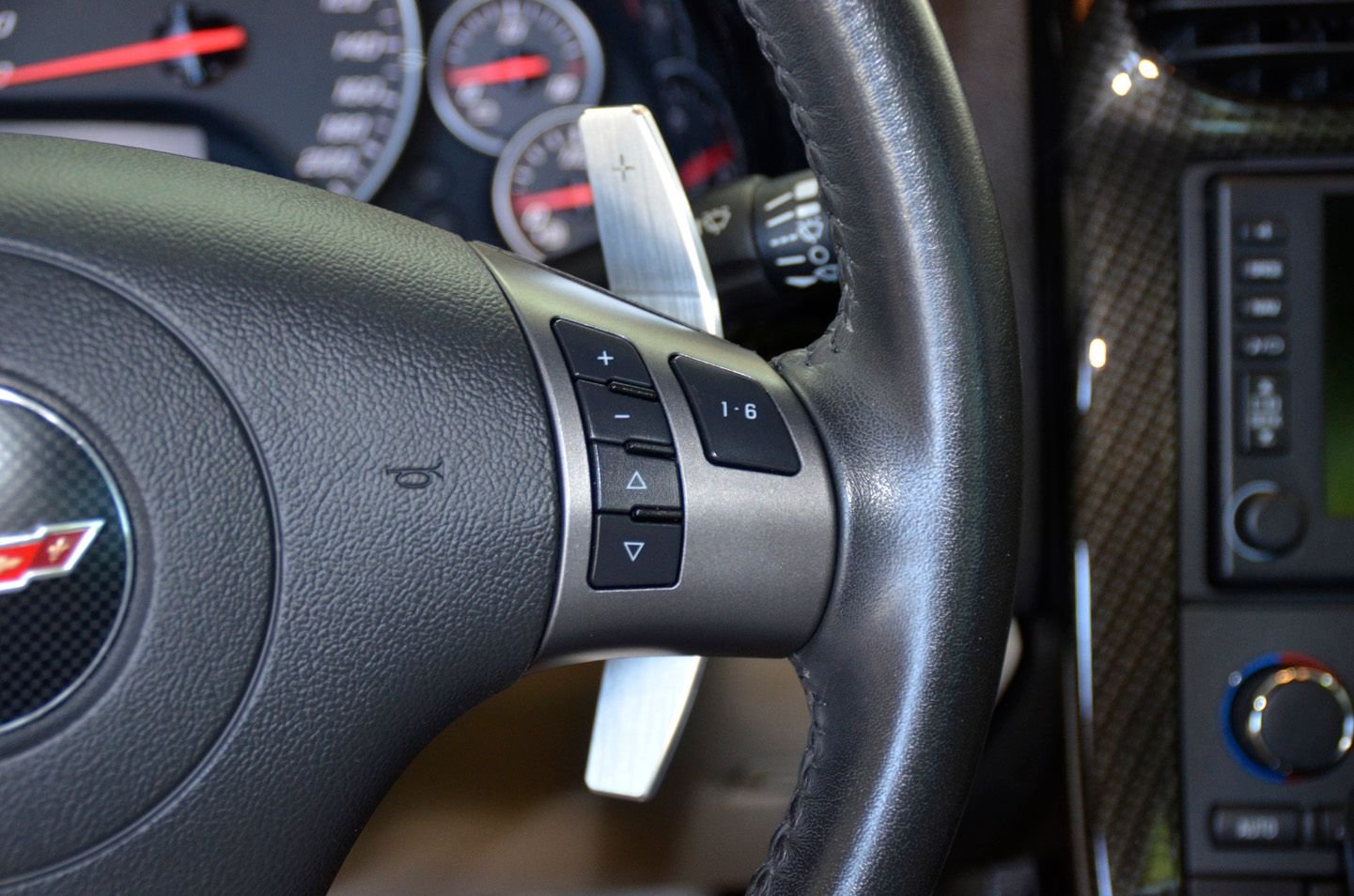

I did the mod when I changed steering wheels about this time last year. I was used to the right paddle being upshift and the left being downshift so I switched the wires in the right paddle using the guidance found here on the forum so that my car matched what I was used to. I'm not a thumb shifter guy and only use the finger paddles so this mod made sense to me. I'm very happy with the change. I even took a little black paint and changed the right + symbol to a - symbol so that the thumb button indications are correct.
It's not a permanent change so if you find you don't like it or want to return it to original condition you would just go in and return the two wires to the original location.
Right shift button

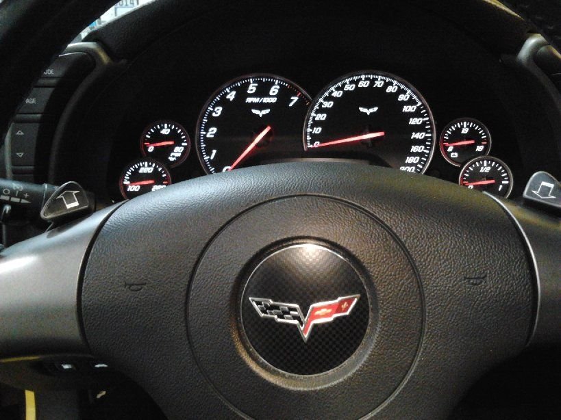

I did the change to the right paddle as well, and I like using the fingers to upshift on the right, and the fingers to downshift on the left paddle. I changed my paddle designation so it is clear what side does what. The arrows show what the thumb will do, the fingers do the opposite. I don't use the thumbs to shift.
To answer BWF07, unfortunately, the paddles on the Corvette are attached to the steering wheel, so the paddles turn when the wheel turns, unlike the higher end cars (Ferrari, Lambo's). Their paddles stay stationary even when the wheel is turned.

The left paddle does the exact as factory, pull with fingers from the back to downshift. I changed the wiring as per the thread by Dan Bratten on the right paddle so now it's pull with fingers from the back to upshift.
I never use the thumb paddles from the front anymore, but the left thumb paddle upshifts , anf the right thumb paddle downshifts.
I changed my paddle indicators to show opposite from factory.
I use the paddles all the time, and I really like the change.
