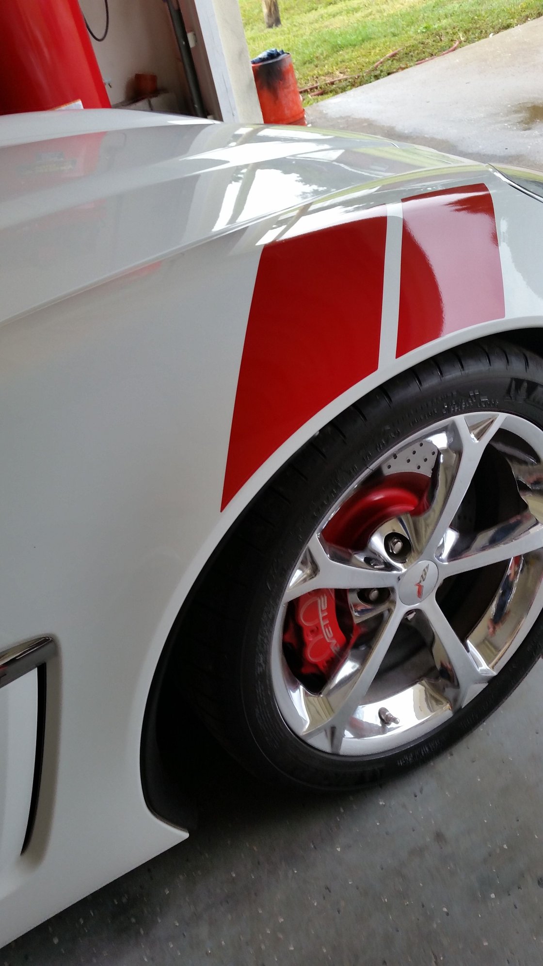

pain in butt and requires work. But you can remove rotors clean rust with powered wire brush. Taped off and paint rotors, I used enamal epoxy paint and baked in oven 1 hour at 400*. Then painted with caliper paint and another bakeing at 400* hour.
Painted Rotor hats:
