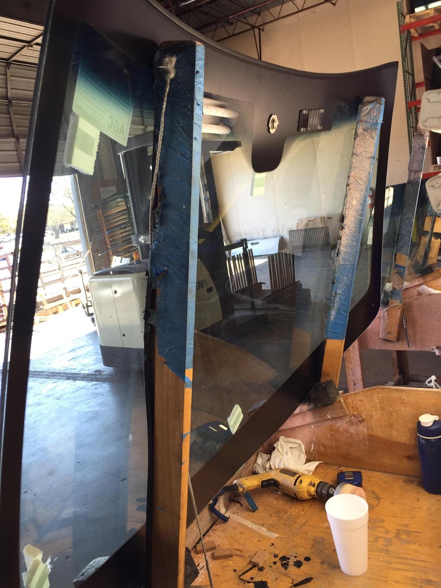

I just had my windshield replace. I have HUD and GPS. The hud glass has film inside the glass to reflect the HUD better. The GPS part of it has a metal bracket as part of the glass. If i didn't have the GPS module, I would not want the gps glass, because it has that bracket there that would look like your missing something.
Here is a picture. Notice the GPS bracket?

I stand corrected. There is a different windshield with that bracket attached. It is for Onstar though, not GPS.
