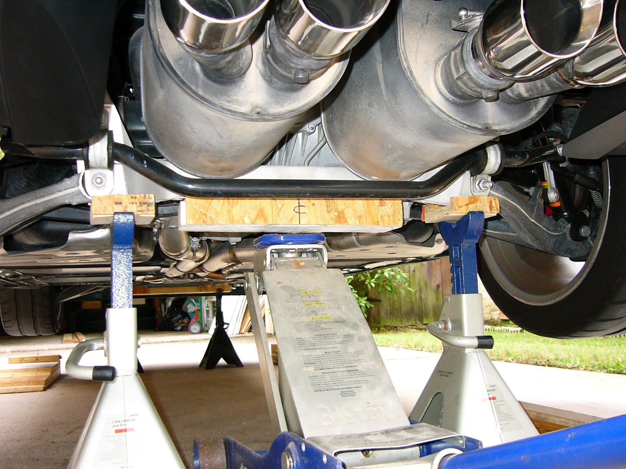

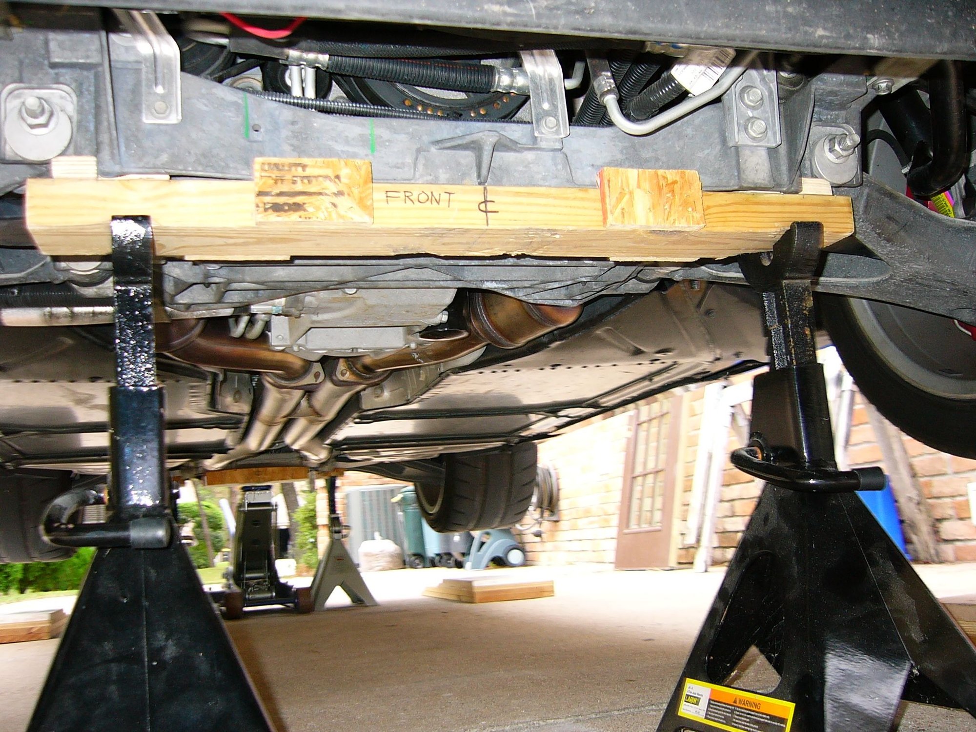

And here's another way that's a little safer
1) Lift the front with your jack in the center of the cradle, support with jack stands @ the recommended locations.
2) Repeat in the rear.
Car up and wheels off in about 5 - 10 min
I use some pieces of 2x4 to keep the steel of the jack and jack stands off of the aluminum cradles and spread the load.
also how I did it. this process works very well.

One jack and 4 jack stands is all you need. Fact is I wouldn't get under a car held up by a jack without a jack stand.

If you attempt to raise your car using 4 jacks at the same time, be careful because the jacks have wheels and can move. Especially if you don't keep the car level and on a level surface.
Also, if you use the frame location points to raise the car and want to place jack stands at the same place, how would you do that using conventional jack stands?
I would suggest using ramps (I have 2 piece extended Race Ramps) to get the front end of high (then chock the front wheels), then use one jack under the rear (Bugman location dark pink) to raise the back. Then place jack stands under the back frame locations.
Then you can raise the front slightly, using one jack at the front (Bugman location dark pink) and then place the front jack stands under the front frame locations.
